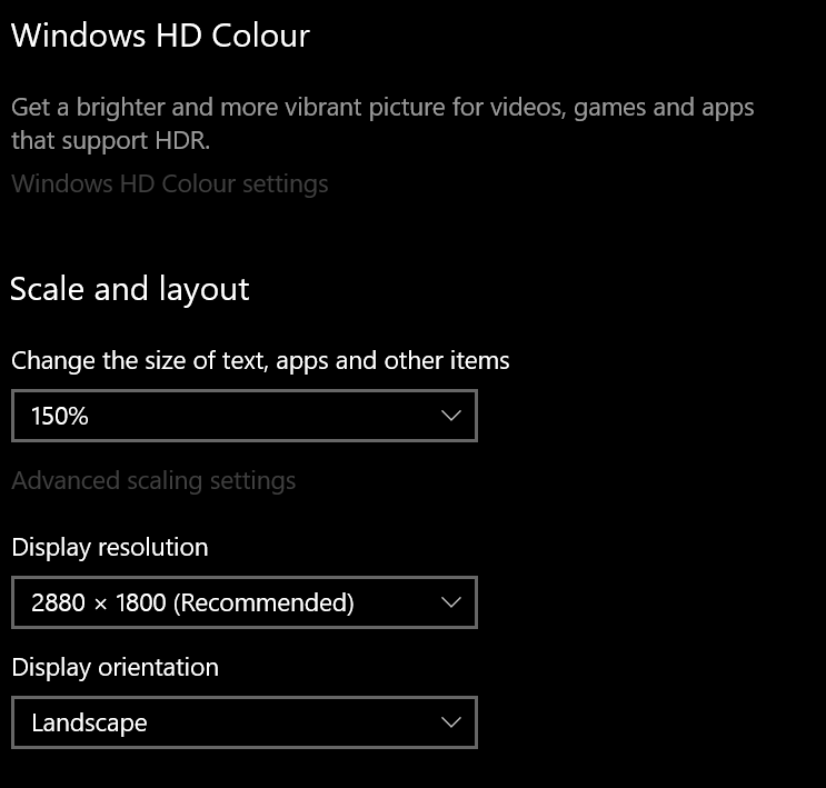

I was one of the first users to report this issue. I had the blur almost at all icons, somehow it is now limited to the status bar:
MacBook Pro with bootcamp

This might be another Radeon issue. Are there any driver updates available for that card?
Can you try any of the following under Options > View > OpenGL to see if that makes a difference:
Move the openGL slider one or more steps to the left
Check/Uncheck GPU tesselation
When I open slightly more advanced model that status bar blur start spreading elsewhere:
even the panel icons become infected:
I know my machine is old, but it still like medieval not a bronze age ![]()
Neither switching the tessellation off or reverting Open GL back to 2.1 or 3.3 helps, except 2.1 makes display completely unreadable.
Radeons turn out to be very problematic and their drivers have become worse with time, there isn’t much we can do about it. If your machine / budget allows, I’d replace it with an NVidia card.
