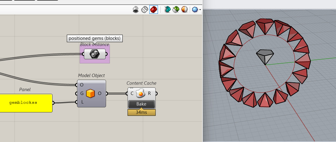

Im trying to place block instances using Grasshopper. The block instances need to have a very specific point as their base point.
I can get them into the correct place in GH, but when I bake them out, either using the right-click option or content cache, the resulting Rhino Blocks are not in the correct position - it seems like the baking operation uses a different origin point?
But sometimes the baking works fine and the gems end up placed correctly
Am I misunderstanding something fundamental about blocks? Or is this a bug?

Hi Sukey_Thomas,
We’ll need the block as well.
This would be a stop ship bug if true.
Here is your definition with a quick block i setup.
Block.3dm (107.9 KB)
I suspect the issue was because of conflicting blocks in the Rhino file, because I cannot recreate the behaviour in a fresh .3dm
When block instances are baked out, is the block definition also baked out if it doesnt yet exist in the Rhino file?
I see there are now two blocks in the file, but one has zero top level and zero nested instances
