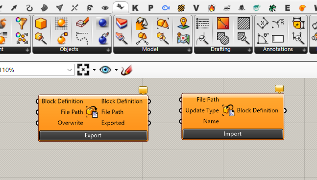

Blocks are stored in your rhino document. So if you open an other empty Rhino file the block definition will not be there. You can save blocks as separate rhino files somewhere on your system. In your grasshopper document you can import these files.
