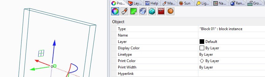

  1. I make my glass pane.
  2. I make it a block.
  3. I select the glass pane (while the Block editor is open) and set Display to Wireframe
  4. It appears as it should -
  1. As soon as I move my mouse, it reverts to Shaded

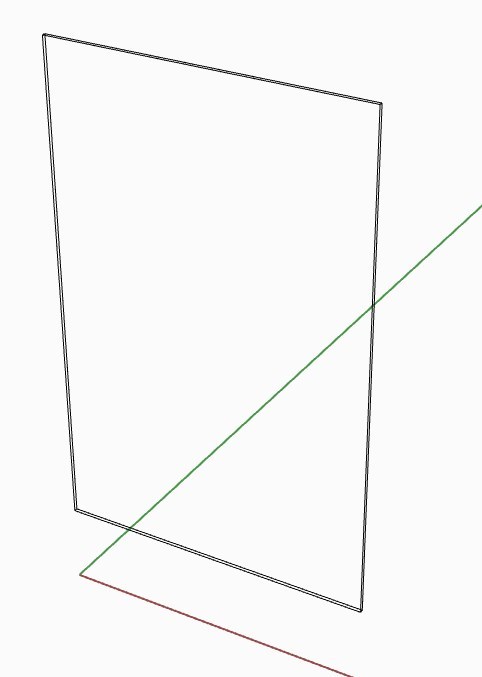

I’m also seeing something but unlike you, the object goes shaded as soon as I exit the Block Editor.
So, I double-click the window to open the Block Editor, select the object, call “-SetObjectDisplayMode” and set this to Wireframe. At that point, the scene looks like this:

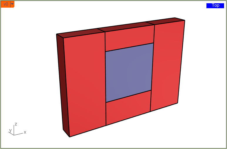

When I then click the OK button on the Block Editor, I get this:
When I now try to select the window, I need to hit it at an isocurve because Rhino clearly thinks it’s in Wireframe mode whereas it displays as shaded.
