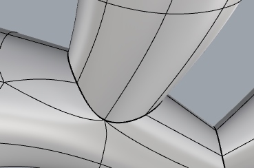

Initial testing shows KeepCreases=No not working. Creases are there, no matter the setting - unless I’m misunderstanding the option. Note the thick edges, indicating that the result has creased edges on the side of the bevel.
-Jakob

Thanks for spotting that @Normand. That is a bug indeed but it’s not directly related to what KeepCreases is for:
Before beveling:
image_a1
After beveling with KeepCreases=Yes
image_a2
After beveling with KeepCreases=No
image_a3
Thanks for the explanation @Jussi_Aaltonen! And cool option with the “KeepCreases” (and makes a lot more sense, than what I was seeing!).
