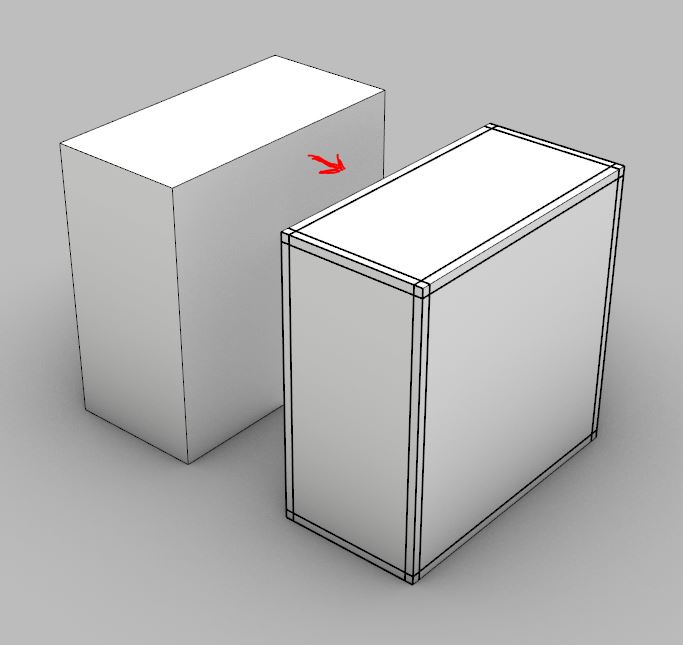

since holding edges are crucial in SubD, will we see a bevel/fillet/chamfer option like this ?
(ability to execute single/multiple edges)

Hi - Could you describe what that option would do? If that is what you showed in the picture in the first post, that doesn’t appear to be producing a bevel at all but only insert offset edges.
yes. like in the pix. I just called it ‘bevel’ because of prev software terminology.
basically the tool adds 2 holding edges around the original & split them at the same time, so
when you convert that to SubD, you get this result:
the prob currently is how to add those edges (requires many steps)

SubD support for Bevel is added into Rhino WIP. See Bevel for SubD.
