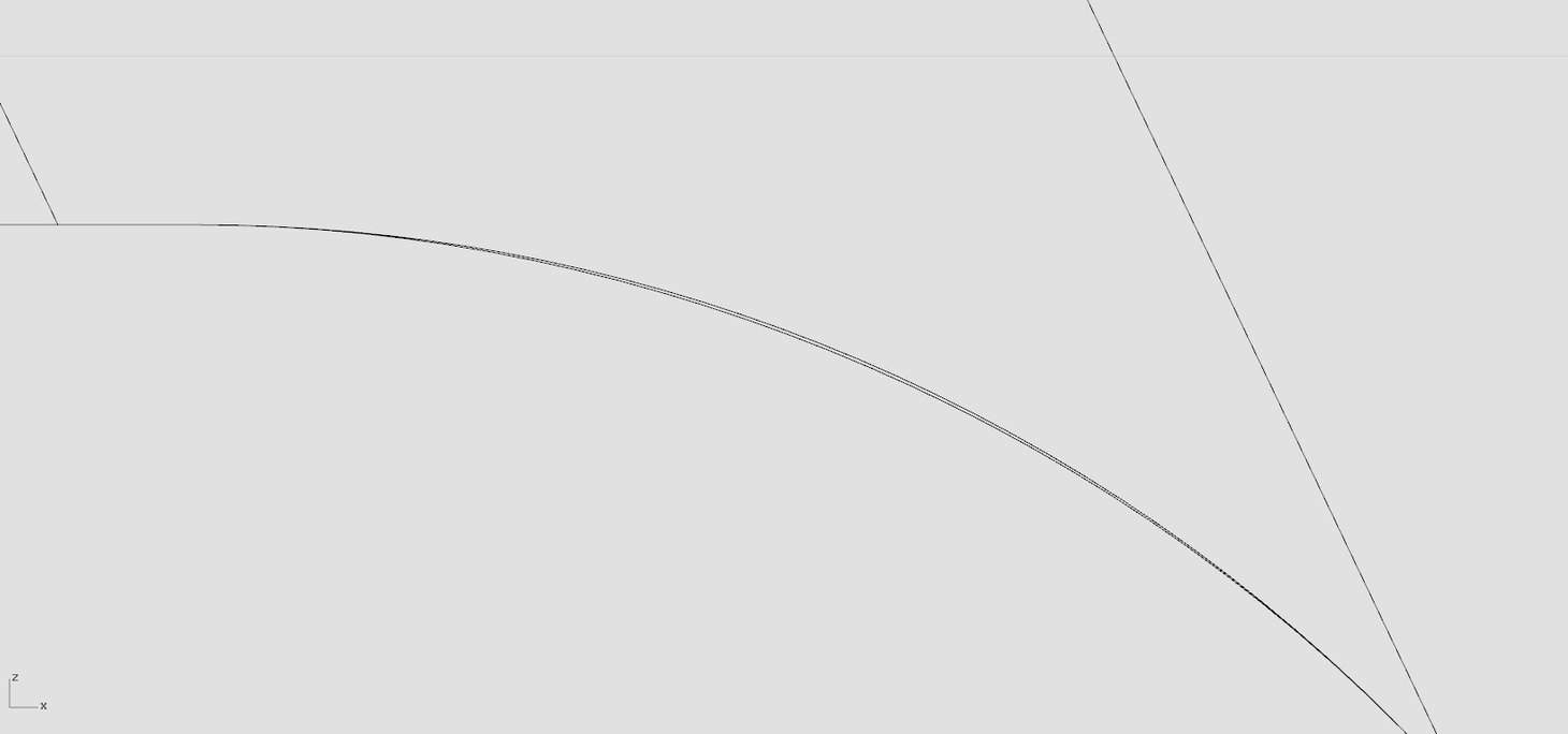

I have also used the trim command in Front view to trim off the excess but now have a double line, confusing to have curves and seeing double or triple etc. I know the representation of a surface s facets can differ from the true edge but does also the line denoting the true edge differ ? should the lines not be as one ?

it fails because it touches another edge, that’s why I always work with edges and isocurves checked in shaded view:
and for a quick solution you can make those Sweep 1 surfaces and the use CreateSolid
and then you can delete what’s left

it wont merge those edges because one of the surfaces is not planar. MergeAllFaces only works on planar faces.

MergeSrf works on any kind of surface while they are untrimmed and similar in structure within the file tolerance.
