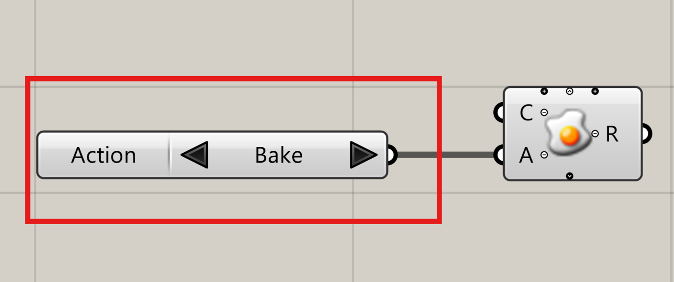

Sorry, that is not what I mean. What I mean is, this is not a Value List.
This is.
In my opinion changing the mode algorithmically is an advanced use case.

Nothing to do with the algorithm, it it just more practical with value list as the menu is already exposed.
Often having both options (context and value list) is the best for everybody.
Also I don’t think it is coherent for the component to offer some possibilities in x state (no button connected) while not in y state. (with button connected).

The component will take the Action or True/False. Tue False will activate the default Button Action, which is set by right clicking on the component. (Push is the initial default.)
The old tooltip was confusing since a True/False could be interpret to do something different than the default action. If the icon reflects the default action in the new release and True triggers the action, that’d be perfect. However, this means you can not do the push>bake algorithmically, hence it’s best to have both inputs with the default action button (for the value list) hidden by default.

If you feed in the sting “Bake” or the string “Push” it will conduct that action. No need to use True/False.
So that first panel will, without any other input:
  1. Purging the first item (deleting and item, purging a block, purging a layer and then deleting all the objects on that layer as Rhino uses both terms)
  2. Push the second item
  3. Bake the third item
  4. Pull the 4th item (note: technically the others 3 also Pull)
