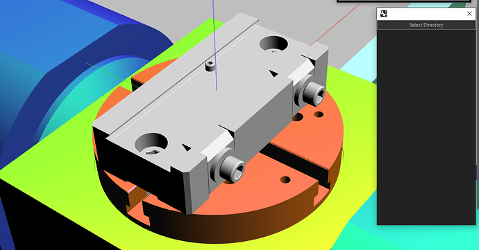

I think I should be able to wrap something up to replace it, and make it more generic.
The idea being, you can just browse to a folder and it will harvest the images. I’ve got this prototype working.
Just need to hook up dragging and dropping the content, and handling the creation of a material that creates an Emap material based on it:
I actually think double clicking the icon to apply should also work.

try: EmapMaterial on PackageManager.
command: _EmapMaterials
(also works on Mac but there the thumbnails don’t work nicely yet)
Usage: load a directory with subdirectories of Emaps and double click to assign to selected objects.
Warning: only briefly tested and might crash Rhino, so pls save your work…
No drag and drop yet
Double click will also add the material to the materials list, even if you don’t select anything
The latter is a bug, or a feature, you may choose

@lander I just uploaded 0.1.6.0, I hope that one works for you.
Looks better now with circularly cropped spheres :slight_smile:

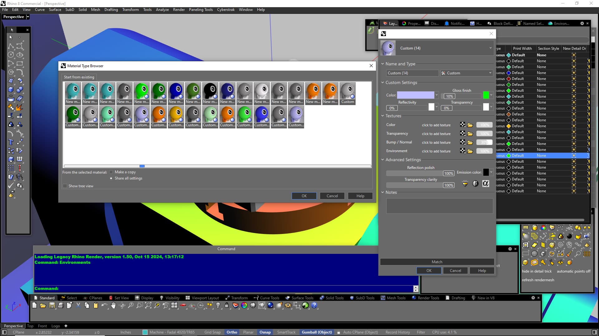

Mine doesn’t look this cool though:
:neutral_face:
I’ll try loading those files I captured years ago . :innocent:
Not sure if there’s issues with the files I’m using though. I think theyre old Auxpecker images.
Ok so I loaded my secret folder with old Auxpecker images and looks like yours now:
:slightly_smiling_face:
Now imma test to see if no crash. :sweat_smile: :crossed_fingers:t4:
Ok so this time it didn’t crash. But the drag and drop seems to be locked, and the assignment didn’t take.
I tried ā€˜selecting object and double clicking material’.
Not crashing though. :smiley:
