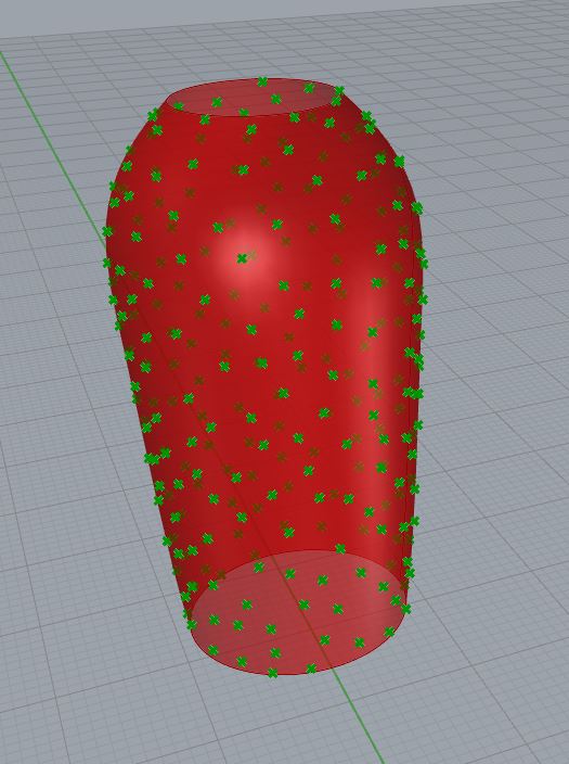

Hi, i made this vase based on a Rhino-surface with weaverbird. How can i do “fade” of holes from the top the base? How can i use Attractor with the Population Geometry dots? Is it useful? This vase should have a closed surface on the top and should open downwards. THX for any help!
Are you referring to gradient point density based on Z values?
Remesh by Color could also be useful
THX alot! i rebuild it and put it into my project. but it triggered a chain of other problems. (check file) I’m new at grasshopper and its hard to find some reasons for data conversation failures.
