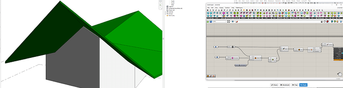

Hello guys, I have created the native Revit wall and roof geometries through Rhino.inside, I am wondering if there is a way that I can extend the walls to attach to the roof, similar to how you can do in Revit? Thank you.
Hi Realtaiwanese, this is still a feature request for the Revit API.
Hi Japhy,
Is there a way to ease the small gap between the profile wall and the roof in RIR other than the attached top and bottom (which I believe we still don’t have the API for such a function)? Thank you
I don’t have any suggestions that will preserve Editable Walls in Revit.
