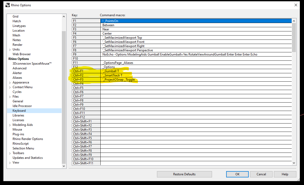

Could you please show me a screen shot of your setting for the above post?
I want use my mouse 4 & 5 for some command toggles, but am just not clear on the exact syntax.
