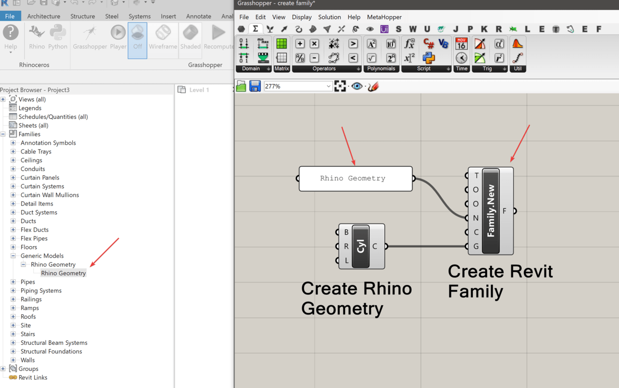

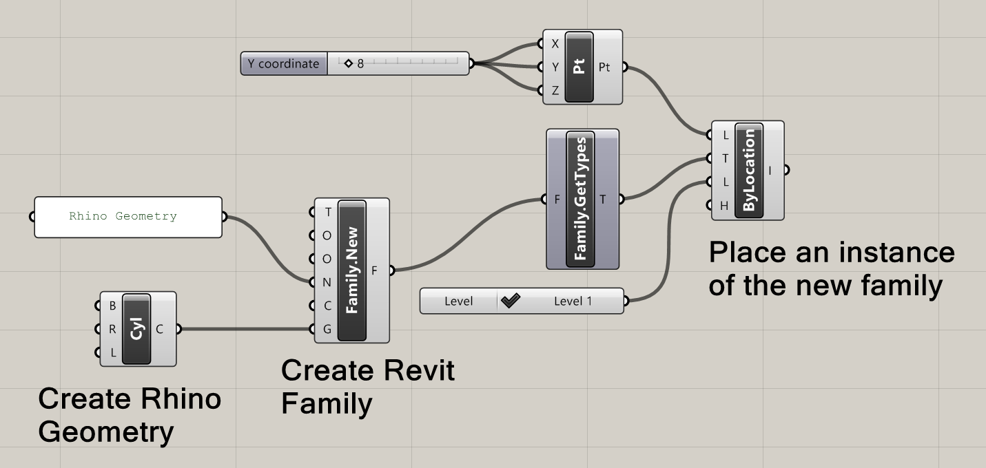

Hey @tobias.stoltmann
See this example please. On this definition, I am creating a very simple Rhino/GH geometry, create a simple Generic Model family from it and placing an instance of the family somewhere in the model.
create family.zip (91.0 KB)

Hmm okay. I’m not sure if I understood correctly but if you remove the “place” nodes in the previous script, the Family.New component still creates the family (it will not be placed) and the Project Browser will show the created family in the tree. You can also customize the category of the family and make it more specific using the other parametrs on the Family.New component

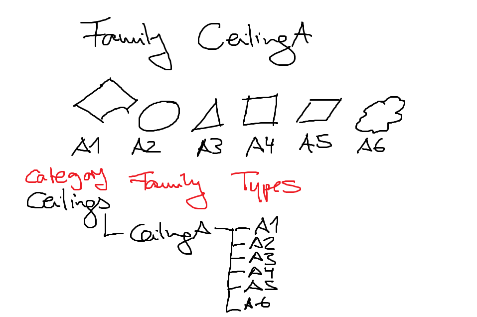

Let’s say I gonna have a really special ceiling/facade as to be seen in the screenshot (sorry for the bad sketching skills).
Every panel in there is really really different. The only thing I was capeable of was to create as many families as different panels I got. And this is getting quite unhandy when you have 100 different ones.
I guess you would frankly not want to modify them as they are really unique, but you’d like every different one to be a type of that panel (=part of the family).
Is that something that is impossible in Revit and therefore requires a new strategy how to organize them in Revit…?
Thanks in advance
T.

I think what you are trying to create makes perfect senes. Assuming the ceiling has a complex non-uniform pattern, abd using Rhino.Inside.Revit, I would:
  • Create the A1-A6 panel types in GH
  • Generate a ceiling grid pattern with insertion points for each panel type
  • Using Rhino.Inside.Revit, create family/types for each A1 to A6
  • Using Rhino.Inside.Revit, place instances of each family type at the correct location
This way you will get a Revit ceiling that is made up of Revit family instances that are individually editable by their type.
If the panels do not need to be modified on the Revit side, then you can generate the complete ceiling geometry in GH and place inside a single Model-In-Place Ceiling family.
Hope this helps. Please continue the discussion though. I’d love to see the final results :slight_smile:

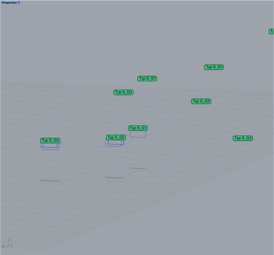

Hi @Rickson, I don’t know if you still have time to look at this problem but I included what I have been building.
The .gh file contains a sample set of the 7 Types using Rhino geometry + a handful of positions for a few of the types; I think it is a different workflow to integrate parameters (to define the geometry) like we discussed last week but this is what I have so far.
This image is an illustration of what I am trying to accomplish (get all types into Revit and place them at a position):
Any ideas you might have for a workflow would be helpful.
TypeGeometry.gh (62.1 KB)
requires elefront plugin. let me know if you have any questions.
