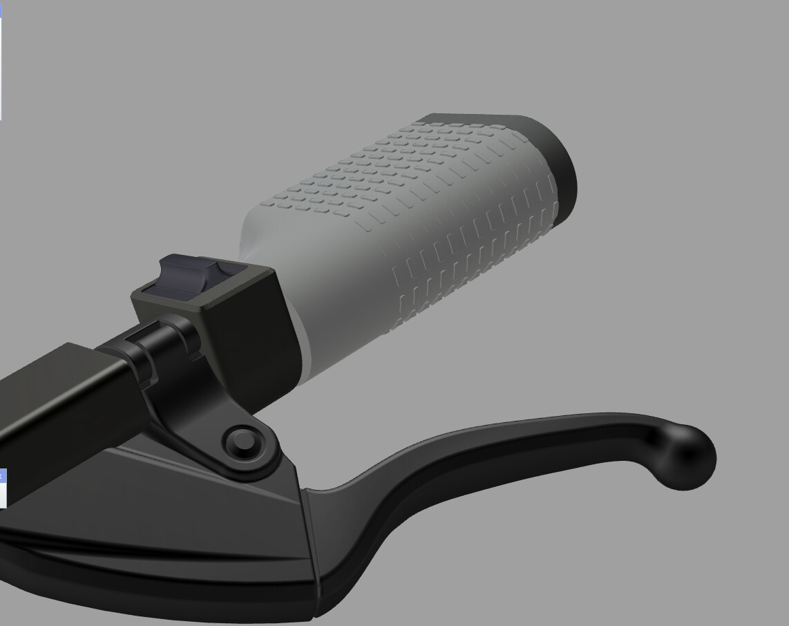

Hi guys,
I haven’t found a way to do this yet. But on the same model I am now facing a very similar problem again.
Maybe this example makes it clearer. The picture shows the handle bar of an electric scooter I am currently working on. Now, the grips will need a 3D structure on them to ensure a good grip.
They could be dots or stripes or so. But I cannot make them go all over the entire object, only on a single surface.
I have tried @eddi s tip here an rebuild the surface, but still no success. Is it only possible in Grasshopper to build such a structure?
Regards, Jürgen
_DupEdge (similar to attached fileAroSrf.3dm (11.8 KB) )
_Join (New EdgeCrv )
_CreaseSplitting (Option _Disable)
_Loft (Crv, NOT extrude)
New, you have a one surface for Array, and not a polysurface
_CreaseSplitting (Option _Enable to revert back in previous state)
Bild_2021-01-28_234049
Thanks a lot @eddi ! I have achieved it with a combination of your lofting technique and the FlowAlongSurface command. Really useful. I still could create the pattern on the entire surface, since the small one behaves slightly different to the main surface. But its a start. Thanks again.
Instead command _Loft You can still connect profiles with two guide curves and use _Sweep2
and _ArraySrf or _FlowAlongSurface
