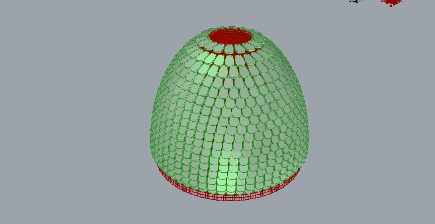

I am currently working on a project in which flakes populate a dome-shaped surface using a series of planes arranged tangentially to the surface. The flakes are placed edge-to-edge along the surface.
I have done another another post to this forum exploring random placement of flakes, and scaling techniques.

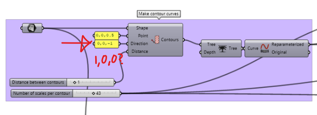

My focus, however, is on arranging the flakes in rows, where each row slightly overlaps the one above it. The question is if its possible to have the flakes start from the back of the dome toward the front rather than following the contours. I have tried to change the direction of the isocurves to y axis but no luck.
250730_flakes-1.2_ΖΕ.gh (26.2 KB)
Not sure if this is feasible, any guidance or examples would be greatly appreciated.
Thank you
Instead of using isocurves to generate the rows, use Contour instead. This way you can use an arbitrary vector for the “axis” of the tiling. In your previous thread I posted a method using this technique. Just use a different vector:
