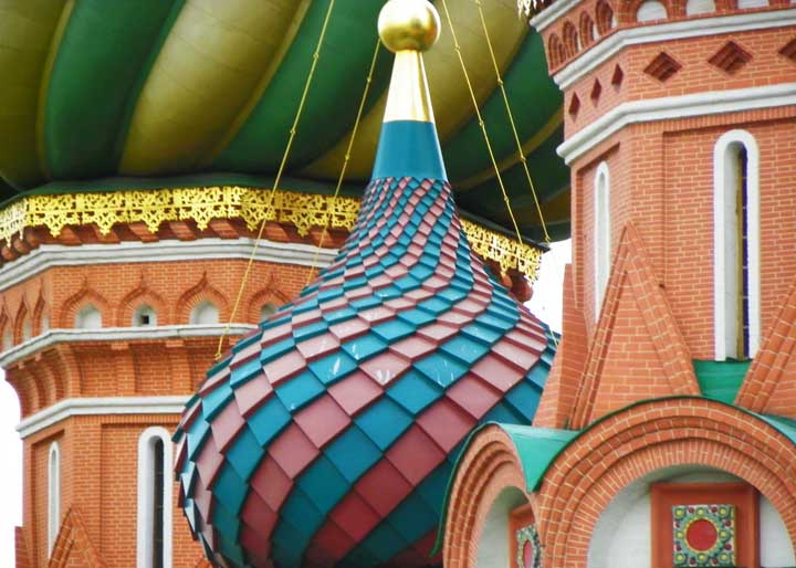

Hi I’m looking to alter the tiling of the this cupola dome to have more square tiling near the top of the dome vs. the skewed diamond shapes. I used the paneling tools to create this. Is there a different method to create this tiling as pictured in the reference image below?
Did you search on this forum and old grasshopper forum ?
Hello - if you look at other images of the dome, you can get an idea how they compensated - the twist is not consistent.
On others where the twist is consistent, the panels do get narrower:

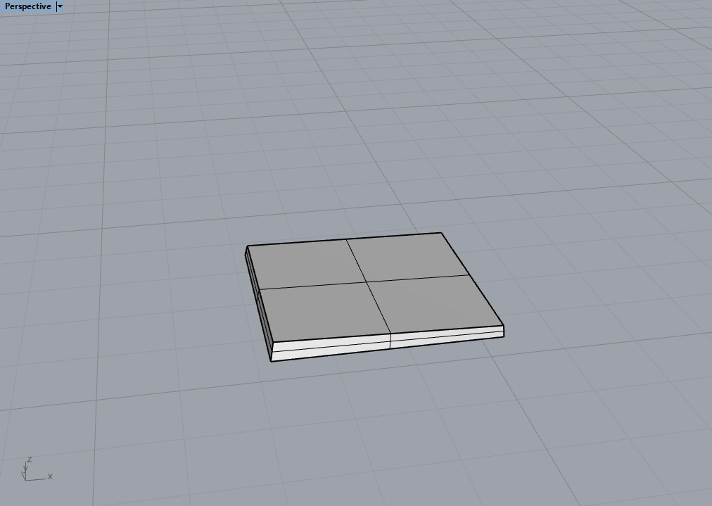

Hi Laurent,
Is it possible to have the dome tiles overlap like shingles without having the
“valleys”. I was thinking the phyllomachine plugin would be a better modeling alternative since the dome is one fiberglass mold that is simulating a shingle texture. I’m attempting to remodel the dome using the plugin, but I’m having trouble finding the “Brep” alternative to translate the tile onto the surface . Is there a different method of execution that would simulate the tile ?
