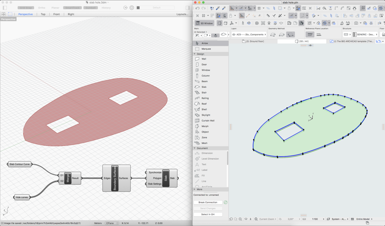

I am trying to make a slab with a hole in Archicad using the surface from boundary curves in grasshopper. Grasshopper and rhino crashes when I connect the surface to the polygon AC component.
This is described as possible on AC ( Grasshopper - ARCHICAD Live connection: Reference ... - Graphisoft Community ) and I was wondering if this is a mac problem or an AC live issue.
Thanks,
I am also having the same issue no matter how simple - I cannot create a slab / zone with a hole in.
I even tried Slab from ArchiCAD > Deconstruct > New Slab in ArchiCAD and that crashed

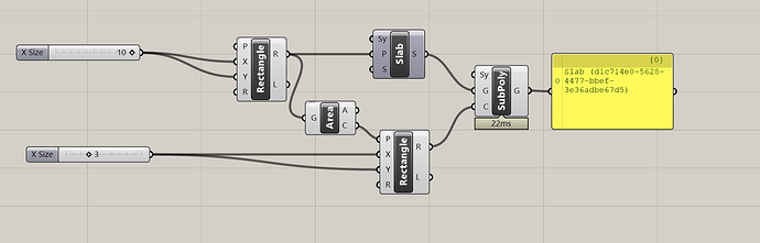

You need to first create the slab using just the main outline and then use the ‘subtract Polygon’ component with the inner outline.
You can also use this method:
refer here: Grasshopper - ARCHICAD Live connection: Reference ... - Graphisoft Community
