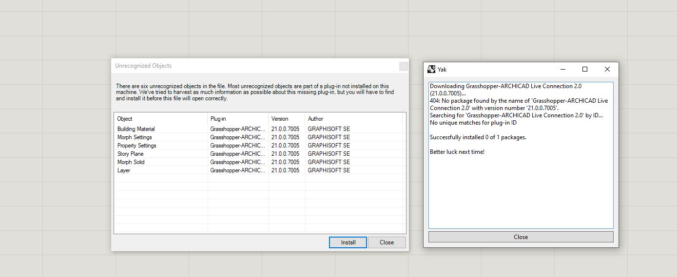

Hi everyone.
I have the same problem and I can´t solve it.
I´m running Archicad 23 and Rhino 6 and downloaded the latest version of the grashopper Live Connection for Archicad.
At first I get a grasshopper breakpoint message when I open grasshopper in Rhino (first image) and then I can´t install the missing components (second image).
Archicad Live Connection tab is also not showing.
The ArchiCad Connection.gha file is located in the Rhino6/Plug-ins/Grasshopper folder. I´ve etried Miguel´s solution but didn´t work.
Any help will be greatly appreciated.
Thank you very much.
Hi -
You are running Rhino 6.3!
The plug-in that you are trying to use requires 6.14 or newer. The current stable version is 6.29.
Hi Wim!
I updated Rhino to the latest version and the problem was solved.
Thank you very much for your help! I really appreciate it.
