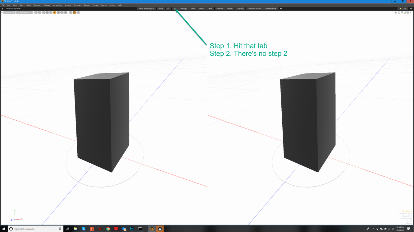

BTW, when I say ā€˜like in Modo’ I mean all I have to do is hit this tab, one mouse-click:
I’m curios why you don’t include this functionality in Rhino WIP, without having to install anything?
The Rhino WIP is already a terrible representative group of users of the real world user base of Rhino. Making functionality like this part of the GitHub underground seems like just more nerd echo-chambering. I don’t get it.
