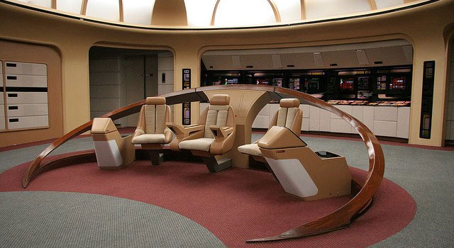

Anyone know how I could go about recreating this shape?
Hey everyone, having trouble constructing the curved wood console piece on the Enterprise D? The main issue for me right now is the corners. Any ideas?

hi @Tellotech pls post a file of what you have so far.
star-trek-tng-enterprise-d-bridge.3dm (140.8 KB)
Here it is
I’d recommend extending the face you build against, then make extrusions of the ground curves, and end up with the attached. These surfaces you should be able to trim on each other.
star-trek-tng-enterprise-d-bridge_sg.3dm (237.4 KB)
Ah that makes sense. Any idea how to blend the ends with the overall curve like the set? They curve the bottom edge between them.
