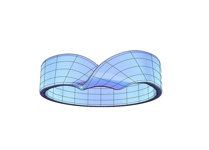

using subd will allow a 2-step-flowalongSrf aproach:
  • draw a z (or s) shaped belt (front)
  • flow it along a U-shaped surfaces
  • flatten the left and right part
  • flowalongSrf to the ring
  • i needed to fix the subd’s normals
  • offsetSubD
above workflow might (partially) work with History.
The SubD at the beginning might profit from another face layout- the already reflects later deformation…
EDIT
second version
same workflow as above - but the initial subD 's faces are more parallel to the first deformation - parallel to the overall axis.
split it at the cylindrical part should result in a nice ToNurbs surface for further steps / edit.
hope this helps - kind regards -tom
