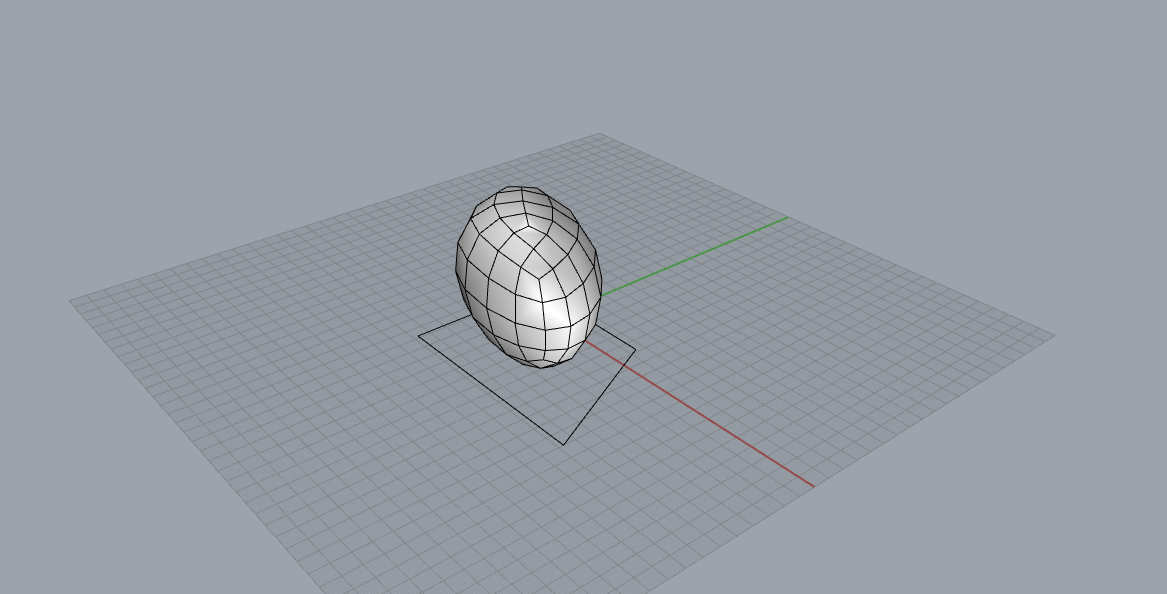

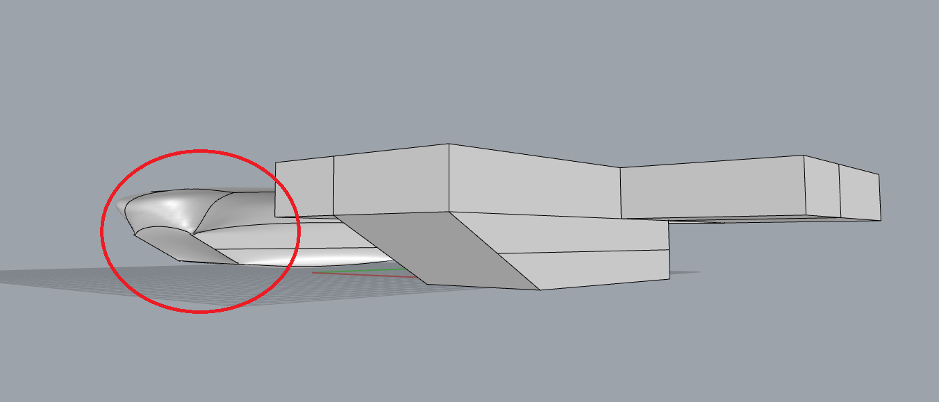

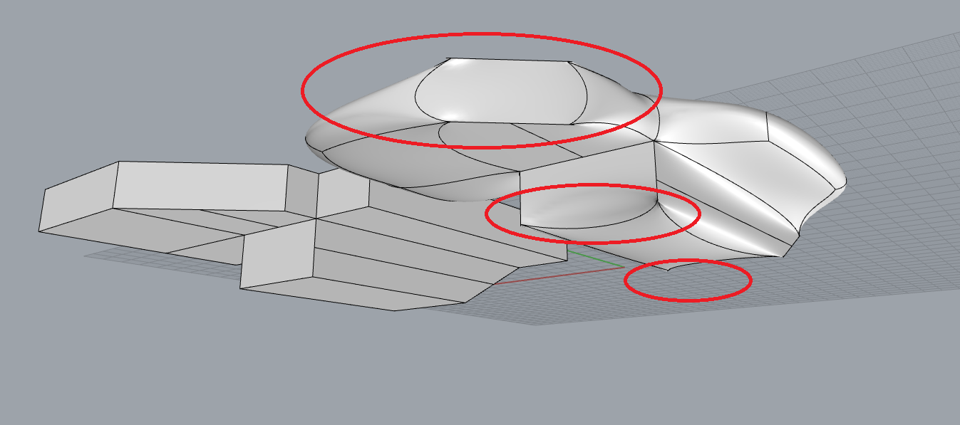

And sorry for my lack of understanding mesh. I’ve tried to mesh my cylinder (or anything at all) but it gives a weird result.
I’ve attached a few images to demonstrate that.
Also, I have tried using the Mesh command on both Rhino 6 and Rhino WIP which resulted in 2 different results. (using the same properties)
is there a clear explanation for this?

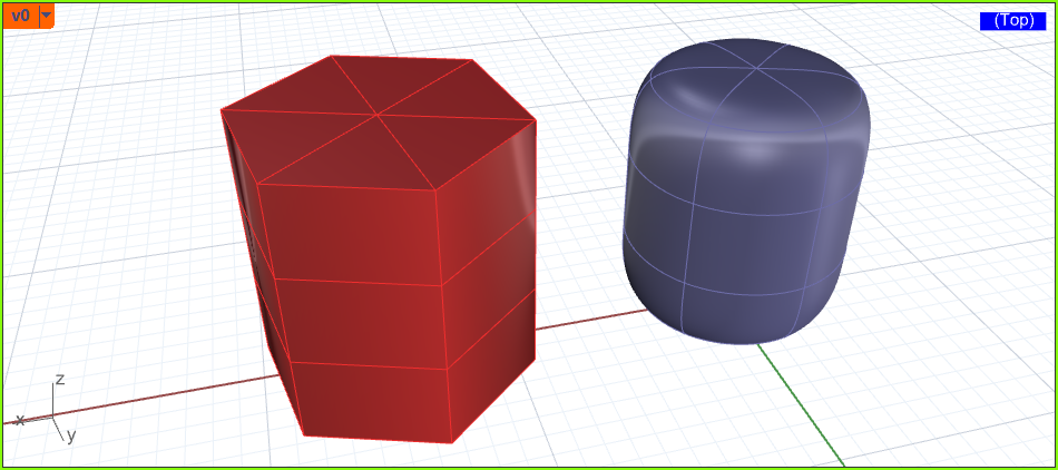

The mesher in Rhino is not made to output SubD-friendly meshes. For a cylinder, you would typically start from a MeshCylinder with few mesh faces - as in this picture (mesh in red on the left - SubD output in blue on the right):
We are currently working to make regular Rhino (NURBS) commands like Revolve, Loft, etc. output SubD objects directly.
I’m not sure what’s going on in the images that you posted - please post 3dm files with input geometry.
As for the Mesh command, that is also under development in Rhino 7, so different results are to be expected. But, again, I’m not sure what I’m looking at in those pictures…
