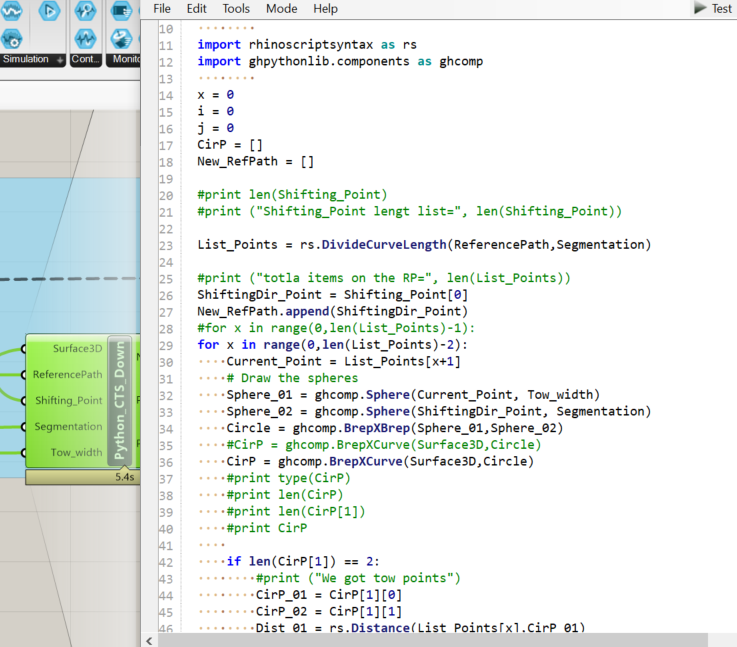

I created a program in grasshopper with a loop using anemone, the loop is running a python script and looks like the code is creating the geometries as I expected, but there is an issue with the run time, it is so long around 5.4 s for each repetition. Please have a look at the image below:
So as the loop is executing the script 4 times, the total computing time is around 24.2 sec, and it causes my program goes so slow. I wonder if some of you can give some advice on what can I do to reduce the run time. Do you think that in my script I’m using not good practices? or it is normal that the program takes a lot of time for its execution?.

I’m using ghpythonlib.components and I’m not sure if that library is causing the long run time or maybe I did something wrong on the scrip.
Basically what the script do is create/propagate more curves over a 3D surface using one Reference Curve and one Shifting curve, it runs an algorithm to find the next Reference curve, and the use it for to generate the next Reference curve and so on.

This part:

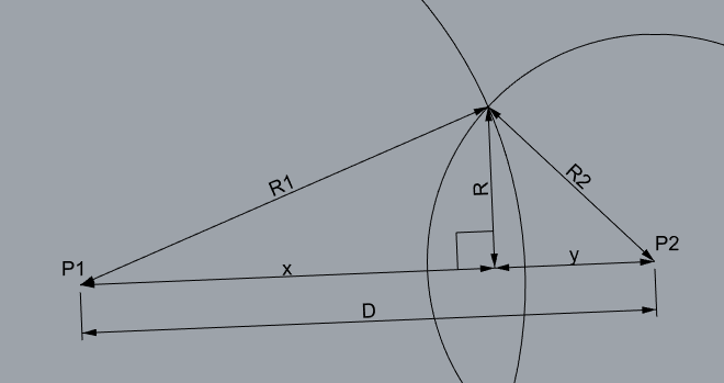

Sphere_01 = ghcomp.Sphere(Current_Point, Tow_width)
Sphere_02 = ghcomp.Sphere(ShiftingDir_Point, Segmentation)
Circle = ghcomp.BrepXBrep(Sphere_01,Sphere_02)
Is heavy but unneeded. Creating spheres and colliding them, and using ghcomp instead of rhinocommon.
Once you have two points and two radiuses, you can calculate your circle.
Simple number calculations will be faster than clashing nurbs objects.

 private void RunScript(Point3d P1, Point3d P2, double R1, double R2, ref object C)
    C = FakeSphereSphereX(P1, P2, R1, R2);
  // <Custom additional code>
  public Circle FakeSphereSphereX(Point3d p1, Point3d p2, double r1, double r2){
    Rhino.Geometry.Vector3d v = p2 - p1;
    double d = v.Length;
    if((d > r1 + r2) || (d < Math.Abs(r1 - r2))){
      // No intersections
      return Rhino.Geometry.Circle.Unset;
    double h = 0.5 + (r1 * r1 - r2 * r2) / (2 * d * d);
    double r = Math.Sqrt(r1 * r1 - h * h * d * d);
    Point3d p = p1 + v * h;
    return new Rhino.Geometry.Circle(new Plane(p, v), r);
Making 500 “fake intersections” (that will still return more accurate circles) take the same time as calculating a single sphere-sphere nurbs intersection
Also, the result of BrepXBrep is a “circle”, but actually a really heavy nurbs curve with many control points, so, using instead a proper circle (8 control points) will make the subsequent steps in your script go faster… probably.

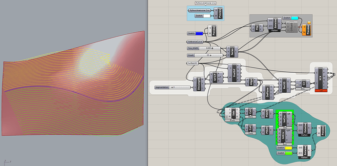

Well, why stop there, let’s take this “perp circles” idea further…
It turns out that the circle intersection method matches OffsetS (Offset on Srf) curves exactly (!) and appears to be faster? Disable OffsetS to see the white group alone.
Naturally, the pFrames had to be aligned with the surface to avoid twisted results so the white group was expanded to use EvalSrf and the machinations added to replace PFrame with an aligned and rotated EvalSrf ‘F’ frame (plane).
CTS_2021Oct14c.gh (85.1 KB)
For reference, the ‘Python/Anemone Crvs’ are internalized without the slow Python/Anemone loop.
Two things:
  1. If you increase the number of offsets in the previous model, the Flip Last component caused confusion for interpolated curves when the “perp circles” intersected the surface on only one side instead of both. To fix that, I used Curve Side (teal group at bottom) to separate points to either the left side (yellow curves) or right side (green curves). Flip Last is no longer used.
  2. In the process, I realized I had used the ‘Segmentation’ slider incorrectly so added a second slider for ‘Count’ (number of offset curves) and kept ‘Segmentation’ for the DivLength ‘L’ value.
Still, the perp circle method is substantially faster than OffsetS (Offset on Srf, gray group at top right), though the latter is visibly more well behaved in some cases.
CTS_2021Oct14d.gh (85.2 KB)
