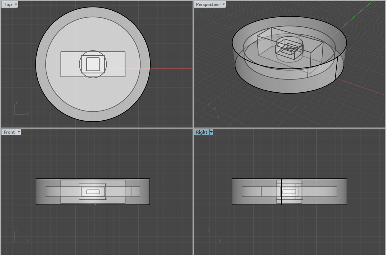

You are talking about the “Concentric” command line alignment option and pressing Enter to “auto-align”? In a quick test here it seems to work, can you post an example where it is not?
ESC will cancel and exit any command, that is to be expected. But Enter should work to auto align.
I’m talking about the ‘align objects’ icon in the left bar
you should post your geometry as mentioned, i dont see that you can do much to make it fail.
Works for me here - Align>Concentric (choose objects) Enter
Cool to see that it also respects grouped objects (the text curves).
I’m on Windows Rhino though.
and in the perspective view, the objects are on the same plane? lay one on top of the other?
No. Align is a 2D operation, not a 3D operation. It will align according to the active CPlane in 2d. The objects will remain separated in CPlane Z.

Well, you can always use two consecutive concentric Align operations, one from the Top CPlane and the second from the Front for example…

“Center of gravity” is not the way these things are calculated - virtually all native Rhino alignment commands use the objects’ bounding box for alignment determination. For example, if “centered” is chosen, it uses the center of the bounding box.
If you want to have something based on the object’s center of mass, a script would need to be written that calculates the volume mass properties for each object or group of objects in order to get the alignment point.

there is something that makes a difference in this file where the alignment works. no ?
No, it does not. In that file, all the objects are lying on the World XY plane. Using “concentric” and the Perspective viewport (Top CPlane), it aligns in X and Y here, but not Z. Like this:
If it were to align centered in Z at the same time, it would look like this:

The second image was simply made with Align twice… the way to snatch victory from defeat…
