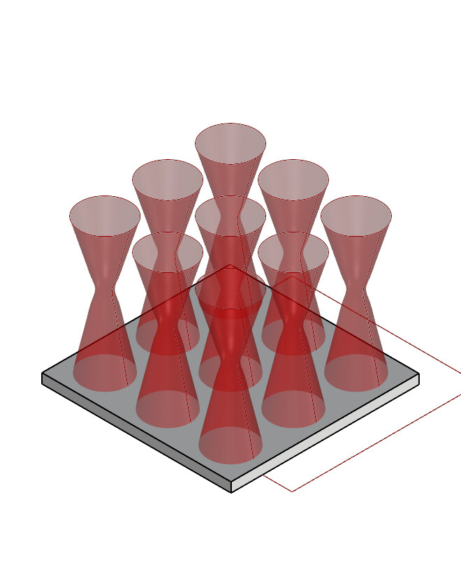

hello does anyone know how to align these objects? i have 9 tubes and 1 box, i wanna move the box to the one of the tubes right in the middle of them like this
or maybe does anyone know how to create another object right in the middle of one of the tubes?
i would be so grateful if anyone wanna help me :<

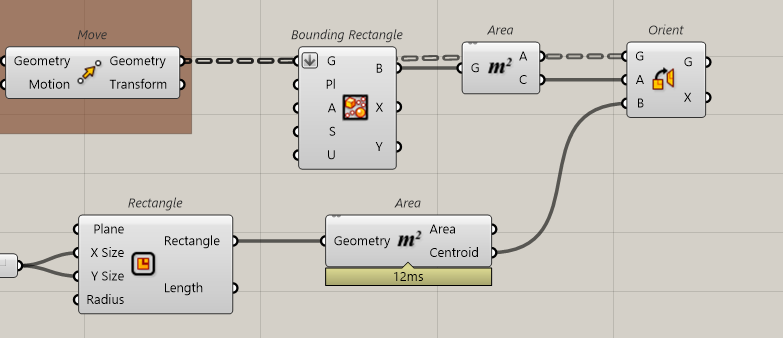

is there any way to recreate this without using plugin?
Yes , martin mentioned
what if i want to align the rectangle right in the middle of the 9 tubes? i tried recreate the way u did but its move all the tubes to the middle of the rectangle
Beacuse the Bounding Box Input must be flatten and you should right click on the component and set it on Union Box
Just download the file linked in my screenshot…
oh sorry i didnt know it linked to the gh file TT anw thank you so much its the same like the way i wanted!
