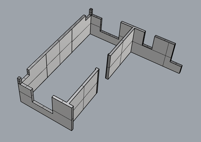

Adjust width of geometry?
How do we parametrically adjust the width if this geometry?
Geometry to adjust width.gh (43.2 KB)

@Joseph_Oster … the answer to both is the geometry was imported (not created in Rhino) and that’s where it was located.
Another way is to bake the geometry and join the necessary surfaces. Then reference them back in and offset. Saves you having to create an elaborate script just to select the correct faces. Or select the outline of each wall as a curve (in rhino, not gh) and use that to drive the offset.

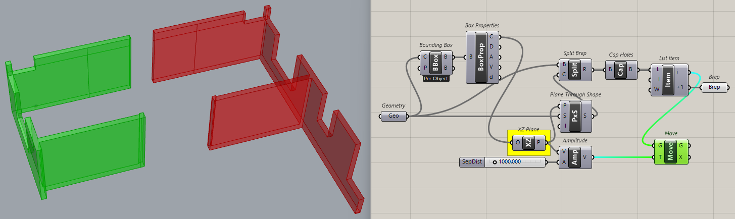

I suppose you could cut the shape in half and move half of it, but I’m not sure how you fill the gap?
adjust width_2023_Jun10b.gh (49.6 KB)

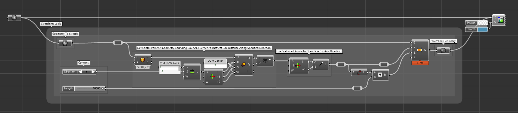

Here’s the stretching logic anyways for what it’s worth:
20240610_GH_Stretch_Logic_01a.gh (49.1 KB)
Graph Space:
Model Space:

Anyways, I expanded on the original slicing logic you created and figured out a way to handle slicing in X, Y, or Z and you can input negative or positive values as well and that influences which portion of the sliced brep gets moved.
The script is a bit bloated and messy but I’m out of time.
Feel free to let me know your thoughts or modify as you’d like. I think it can be simplified greatly but the basic idea is there at least.
Also the Merge Coplanar Faces component is bugged in 8.7 and 8.8 but when that’s fixed it should return a dimensionally accurate “sliced and stretched brep”.
Though I have not tested it, the logic should work to be able to move the plane wherever you want it (offset from the middle of the bounding box to wherever).
This only works with orthogonal geometry. Well… it might work with other geometry but the result will look… well you’ll see haha

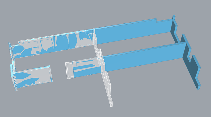

@MJD Gotchya,
Here’s a start, isolating the vertical faces, offsetting, extruding and remerging.
Annoyingly the Merge Faces is bugged but once that works it will give you a clean Brep result again.
Likely someone can come up with a better code solution but is this helpful for your purposes?
Graph Space:
Model Space:
