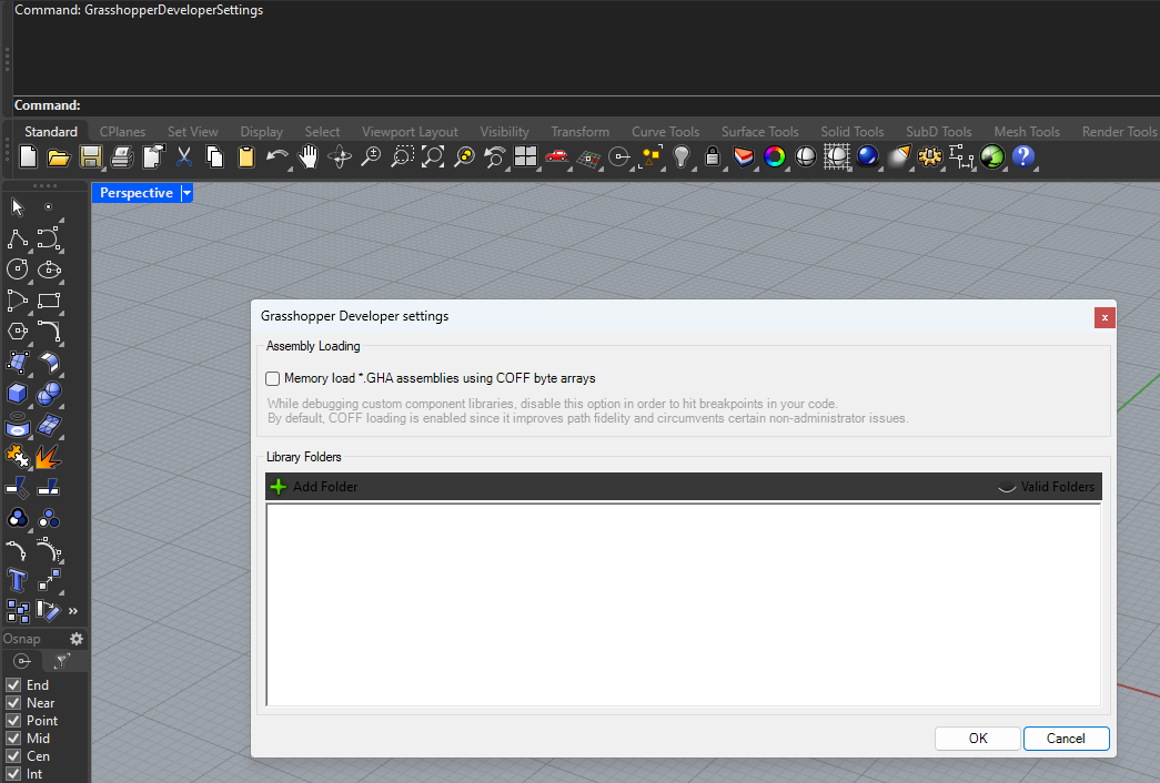

Hello everyone,
When I run the GrasshopperDeveloperSettings command, I can manually add plugin folder paths so Grasshopper can load custom components from those directories.
I’m wondering if there’s a way to add a folder path programmatically, either by using a batch script or a Python command, so I don’t have to add it manually every time.
Has anyone done this before or knows how to achieve it?
Thanks in advance!

You could edit the contents of grasshopper_kernel.xml in %APPDATA%/Grasshopper before you load Grasshopper.
Paths defined in GrasshopperDeveloperSettings dialog are stored there in a | separated string.
 <item name="Assemblies:Folders" type_name="gh_string" type_code="10">C:\example\plugin1\bin\|C:\example\plugin2\bin\</item>
But just to be clear.
When using the command dialog - you shouldn’t have to do it everytime. You only need to do it once.
Beware that any changes made using the command dialog are persisted only if you exit Rhino properly. Killing the rhino.exe task via Task Manager or from Visual Studio by stopping the debugger will make it fail to save your changes.
