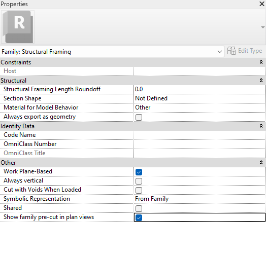

Hi everyone,
I have several families that I’m trying to toggle these property settings in(under Other). How can we access these and modify these en-masse?
Any direction on this is much appreciated.

But I’m looking for the property of the family - for ex: Show family pre-cut in plans
I couldn’t find it in the inspect elements. (maybe I’m missing something)
Sorry Its a Family Parameter, Can’t be accessed through the Inspect Element.
Let me see if we can find a way through Revit API.
Hi @SashankPs,
the following code will serve your purpose
ShowFamilyPreCut.gh (5.2 KB)
@MSAwan this is perfect! Thanks a lot.
