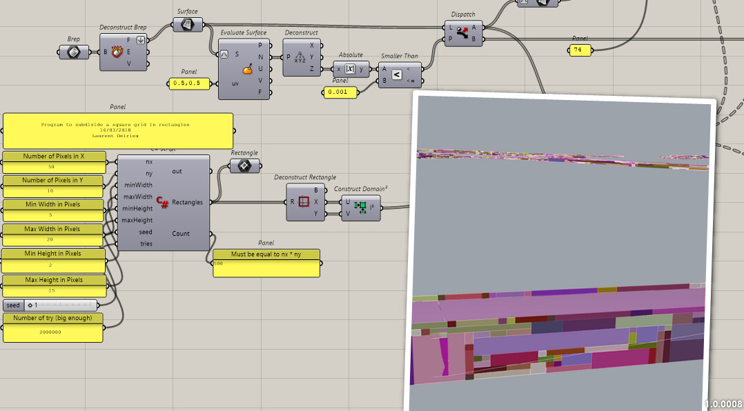

This is a very impressive script. And I have been trying to apply its to a wavy surface. And all I am producing is errors. Note, I am also using v-ray as a renderer. I am trying to achieve a surface like this brick facade but for a small bench.
There are many scripts that does quite the same things. Depending on that it is quite difficult to know where is your problem. Also wavy or not if it is a surface, the parametrization in U and V can be normalized so it could be possible to apply a “brick pattern”, also if it is a cylinder it is possible to have a nice pattern without the seam.
If you want some better answer post a script with the surface you are working on or a similar one (UV speaking) if you want to protect your work.

Hi Laurent, here is th
Sandstone Bench_2025.3dm (4.6 MB)
e rhino file! I am trying to get this texture/profile on the sides of it.

I looked at your file, your “surface” are not Rhino Surface but polysurface/Brep and some faces are trimmed. I tried some ideas but at the moment I don’t know how to apply my script or similar ones to your objects. I can make some “bricks” but just on untrimmed surface
IsoTrim is working but outputs surfaces, in order to use it it should be better if it outputted trimmed surface that could perhaps be “cut” by “Retrim” component.
bricks.gh (189.1 KB)
So if just for rendering the best is surely to follow @BTH advice.
It is possible to do something like that, a bit “Capillotracted’“
bricks_2.gh (31.6 KB)
