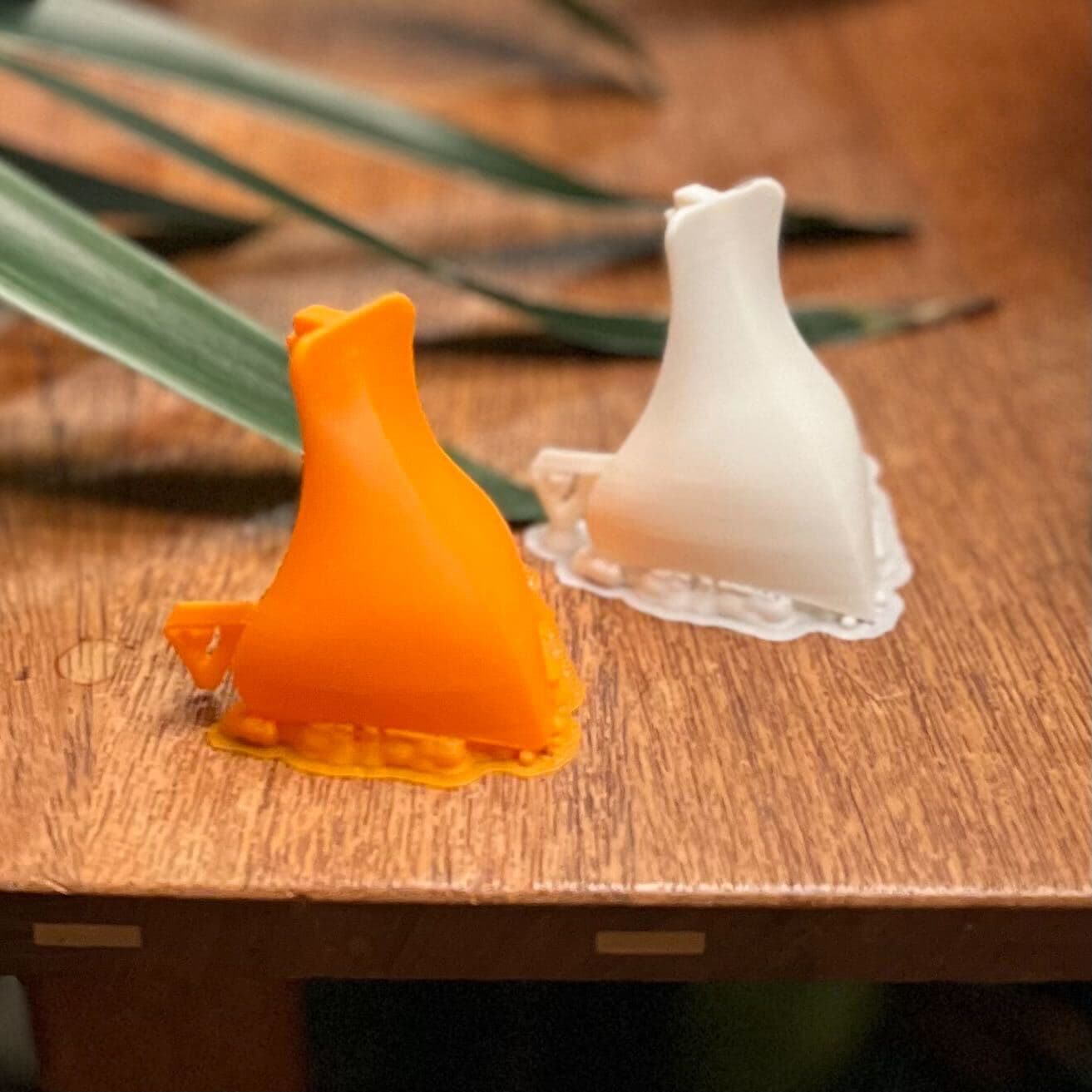

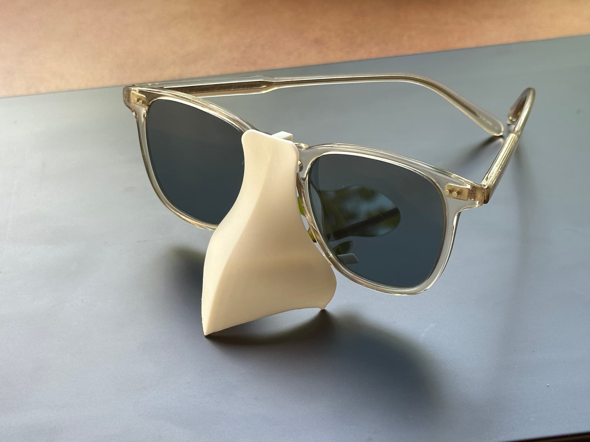

I made a clip-on nose shade for my sunglasses.
Does it look ridiculous? of course
Does it protect me from sunburn? absolutely

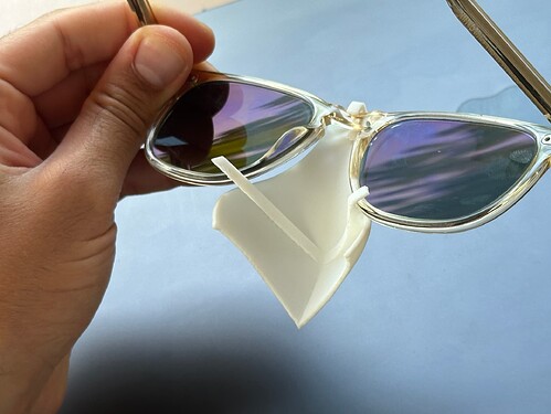

I think it should fit most glasses. It’s held in place with its own tension, The legs are under pressure pushing themselves apart causing the whole thing to slide down putting tension on the bridge.
Here’s the file if you wanna look ridiculous too:

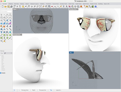

The process:

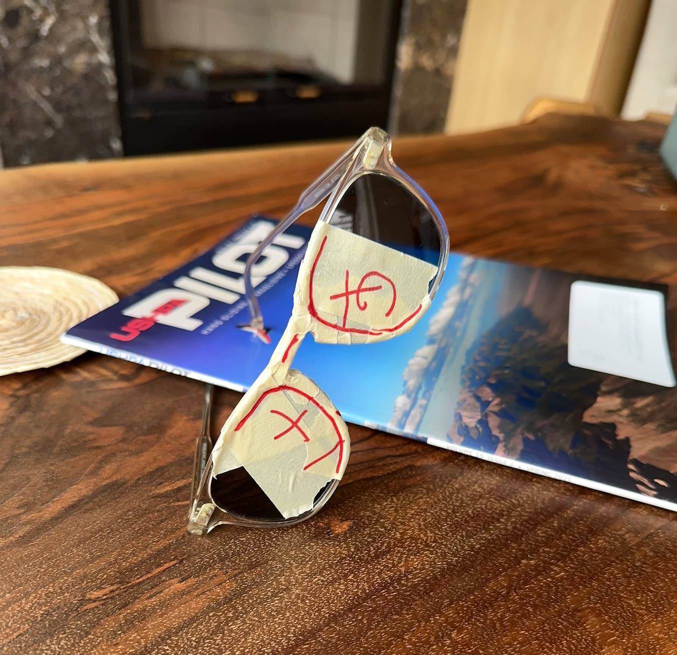

  1. I used iRhino3D to scan my sunglasses.
    I had to tape the translucent material with tape to make it work. Scanning clear material isn’t easy

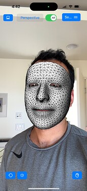

  2. Scanned my face for reference (also with iRhino3D)
  3. Modeled in Rhino (just a sweep2 surface mirrored)
  4. Virtual testfit using AR mode in iRhino3D
  5. @brian 3D printed a couple of iterations on his Bambu printer
  6. Testing in progress
