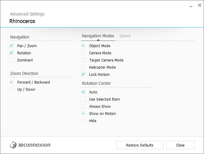

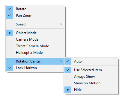

EDIT: with the command “! _SpaceMouse _Popup_Menu” there are some of the options but now the movement is quite choppy. I still suspect my .rhp is not the right one.

The correct 3DMouse plug-in for Rhino is part of the Rhino distribution. 3DxWare has never installed a plug-in for Rhino.
Possibly stopping the 3Dxware driver, deleting / renaming %appdata%\3Dconnexion\3DxWare\Cfg to clean up any incompatibilities with older user profiles helps.
Sometimes a new install of 3DxWare requires a reboot.

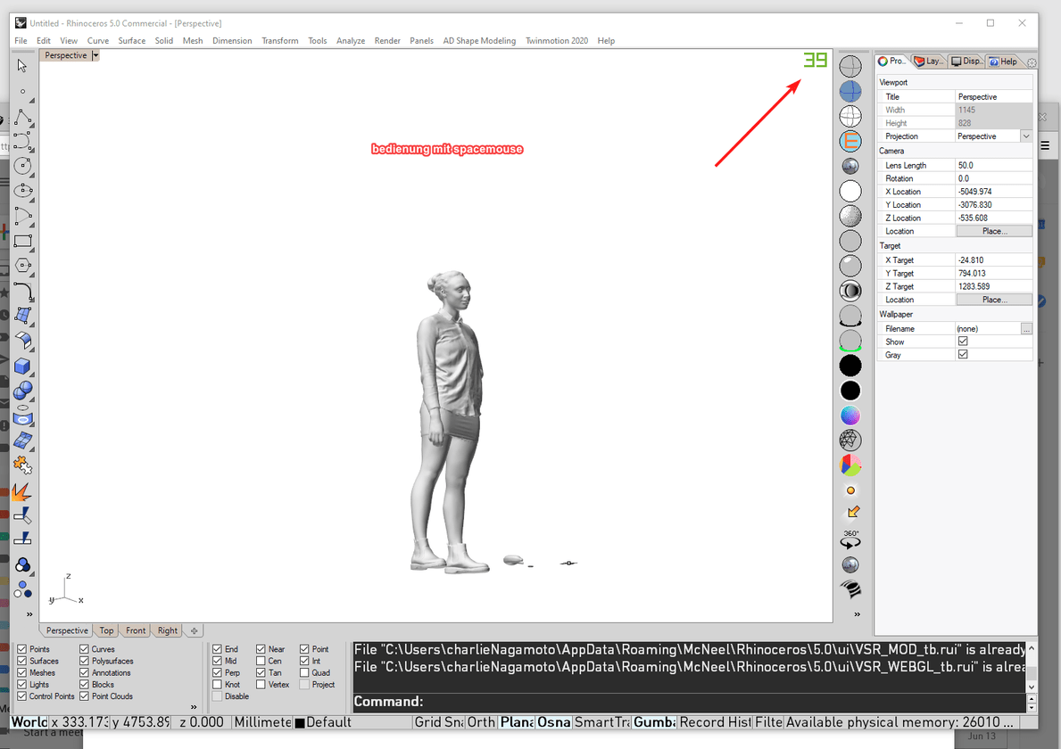

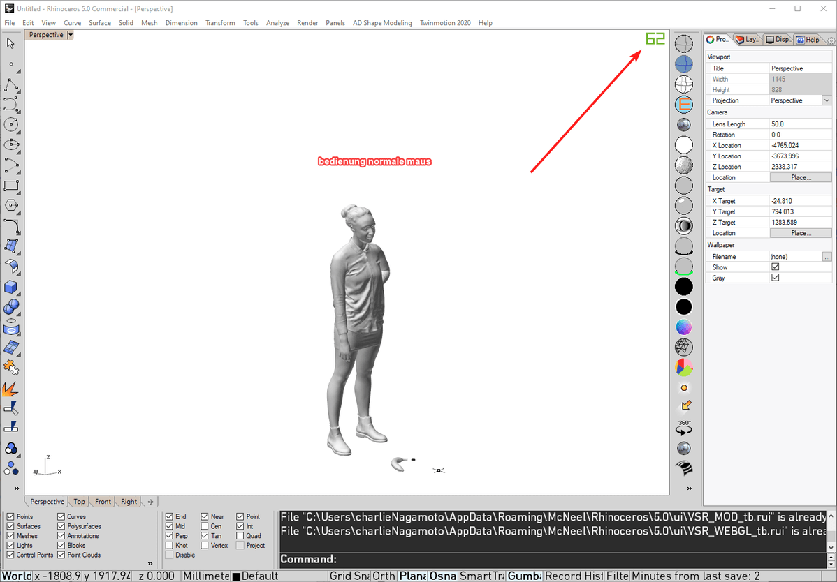

sorry to bother again, but I am still at odds with the driver/plugin form 3d connexion. when I use the spacemouse the framerate drops to around 40 (from locked 60). It’s pretty bad and stutters heavily. I look in the 3d connexion forum and it seems there having quite some problems with their software. :face_with_raised_eyebrow: I tried the following but without luck so far:
  • updating gpu drivers
  • calibrating the device
  • turning logging off/on
  • all versions of the 3d connexion driver
  • unplugging all usb devices other than spacemouse
  • uninstalling logitech drivers
did someone encounter this frameratedrop alswell?
thanks again
spacemouse:
normal mouse:
