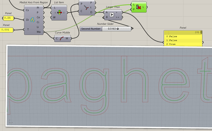

that was not so difficult but I didn’t put great effort to finish it.
I decided to make it with the same logic as some other components. So it generate alone the region (contour and holes)
Medial axis is outputted as polyline so it could be possible to filter short parts,
… but it works not perfectly, it depends on the tolerance chosen here 0.001 and the curve division
here 0.005 curve division 0.2
here 0.005 curve division 0.5
I have thinks to tweak things (ratio tolerance curve division …)
It works on whatever planes
Circles could be sorted so it is possible to have the biggest in-circle for labeling
