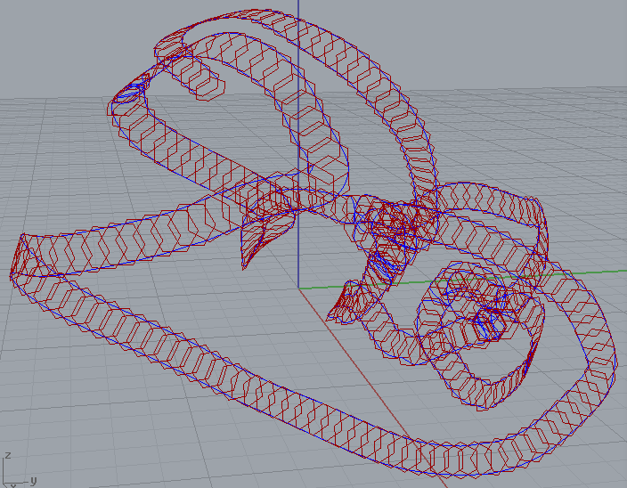

Ok guys here’s the thing i need to get the outline of such shapes stacked one on another i tried to tackle this many times but always it was like - eh maybe i will figure it out down the way. So im dropping here internalized data: OUTLINE_DATA_COMPLEX.gh (207.1 KB)

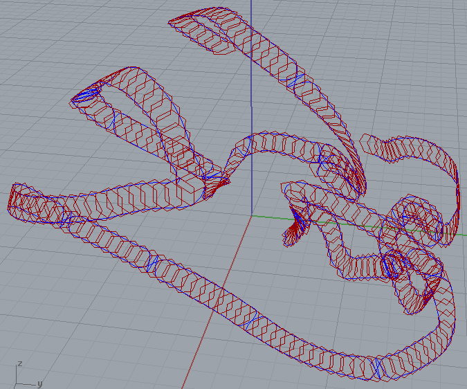

@HS_Kim @Adam_M Ok guys i tried both but we have small problem unfortunatelly due to my oversimplification of prepared data. I updated first post with proper complex set.

This play gets confused at three points where the line of hexagons crosses itself:
OUTLINE_DATA_2019Jul4a.gh (49.5 KB)
P.S. My method was different but I too made an assumption based on your original post that fails with your updated OUTLINE_DATA_COMPLEX.gh - back to the drawing board. :frowning:

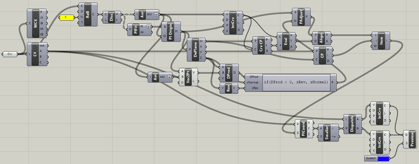

OUTLINE_DATA_re.gh (235.3 KB)
Interesting challenge!
I’ve not deeply tested but it seems to work.
The idea I followed was to:
For every curve “C” find the best fitting plane, will call it “P”.
Shatter every curve dependings on all the intersections found by MCX.
For every segment find mid-point.
Create a sub-lists containing all the curves that have one or more intersection with current C curve and project every of them to the relative P plane.
Do the curve-inclusion test for every mid point with all the projected curve, keep only mid-points (segments) that are always outside.

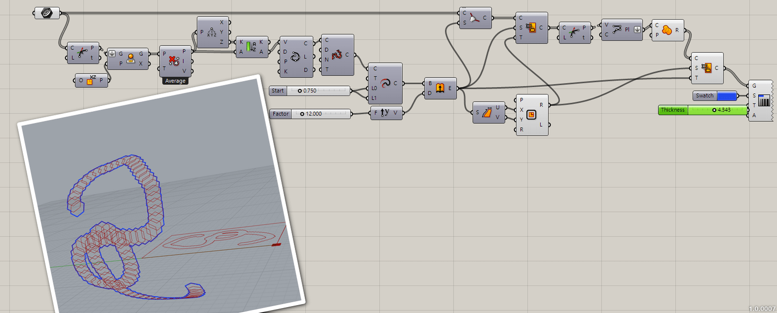

Bingo! Actually, i want to do nondestructive curve bounded paint in full degree of freedom not constrained to any projection plane.
My solution still uses projection, not globally but locally.
I think it would work in most cases, but if your “stamp” (the hexagon) is created in a very curved space (with adjacent hexagons even more curved) it will probably fail too.
The solution would be trimming the actual mesh/brep with each stamp and use that… very heavy…
Thats why i’m reaching out. My most succesfull approach was using simplified spheres joined and intersecting them with underlying geomety. However it’s not cheap to compute. Probably next step here would be to try adaptive marching cubes with adaptive iso to create multires metamesh and then check for intersection - but i guess there’s something what im missing here and whole procedure could be simplified.

Not consistent ? Each stamp is conformed to mesh normal and then pulled to fit exact shape of it so if you are calling junk data pulled curves which are intersecting exactly ON mesh well … Here you have whole set if it helps in anything OUTLINE_ALL_DATA.gh (664.0 KB)

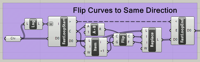

In this model, I used Anemone to first flip curves so they all have the same orientation:
OUTLINE_DATA_COMPLEX_2019Jul4b2
OUTLINE_DATA_COMPLEX_2019Jul4b.gh (222.7 KB)
