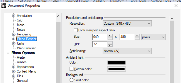

When I select my render plugin as the current renderer, the Document->Render Properties options change.
However then flipping back to the Rhino Renderer, this panel becomes…
I take it this is a bug? Shouldn’t these screens be consistent? If the user selects the Rhino Renderer and sets a resolution, and then changes renderer, the resolution does not get copied across. I think this is creating a lot of confusion for some users.
Now - with the “Lock Viewport Ratio” UNTICKED in the Rhino Render properties, the Rhino Render panel renders to a resolution set in the NON-Rhino Render properties (ie. in the above case, selecting the Rhino Renderer and rendering, Rhino sets the resolution to 400 x 200 - but of course the panel to set this resolution is not available to the user when the Rhino Renderer is selected!
In summary - the Rhino Renderer is rendering to a resolution set in a panel which cannot be accessed whilst the Rhino Renderer is enabled.
Further to this, you can see in the render above the Rhino Render FOV seems to be arbitrarily set (it’s not using the HFOV, or the VFOV - so what is it using?). Also, how can a rendering plugin get the FOV that the Rhino Renderer is using? Without being able to access the FOV, there is no way for a rendering plugin to match the FOV used by the Rhino Renderer. I’m currently using doc.Views.ActiveView, but of course the FOV obtained from the ActiveView is that of the Preview window, not the FOV used by the Rhino Renderer.
Hope this all makes sense - and that there are some solutions.
The first time you switch from “Renderer_A” to the RhinoRender, the render resolution settings are copied. Subsequent switching between “Renderer_A” to the RhinoRender doesn’t copy render resolution settings, in my testing. All this seems to be by design. If you feel the behavior should be different, then I suggest create a new post in the Rhino for Windows category and lobby for your position.

It’s not for me to decide if this is the correctly functionality or not. However it is very confusing to the user. If it’s an important enough issue for a user - they can post it as a feature request.
This isn’t something I’ve been able to reproduce. What am I missing?
Start Rhino with current renderer = Rhino Render
Set Resolution to 100 x 200 via the render properties
Change the current renderer to OctaneRenderForRhino
Set the resolution to 1000 x 500 via the render properties
Change the current renderer back to Rhino Render and check the resolution (which will show 100 x 200)
Render - the resulting render is 1000 x 500, which is incorrect, since the render properties show 100 x 200
If you now update the resolution to 200 x 400 and render, the correct resolution is used.
