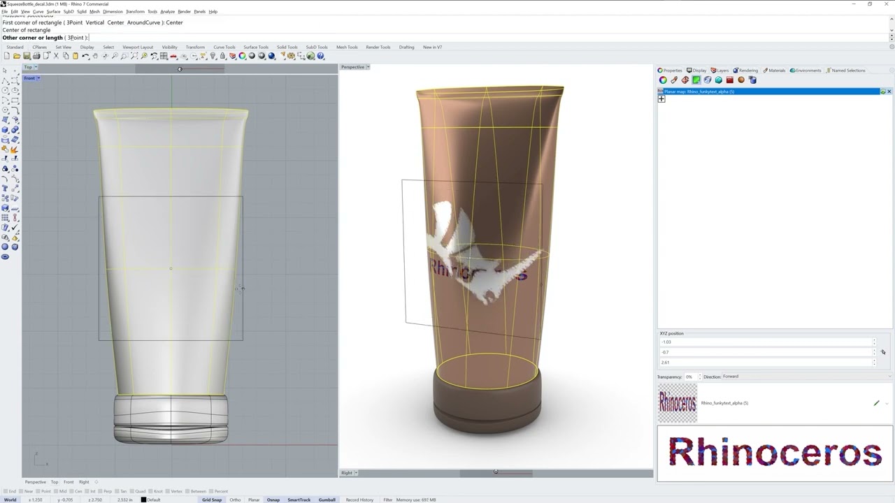

Like this?
Hey! I have seen that video and tried to follow along. It is very intuitive.
However, the decals won’t show for some reason (I don’t know if it has to do with my PC or is within the file)
In Rendered mode decals won’t show when used on objects with transparent material. Change the transparency to 0 and you’ll see it works:
This is a limitation of the current system.
If you want to get a good decal on your plastic your best approach would be to do a cylindrical mapping, then use the mcqueen image in the basecolor channel and in the opacity channel you’d put a version of the mcqueen image but only the alpha channel saved. Uncheck the repeat icon for both.
I made a video tutorial on this technique some years ago:
(and later reply Emboss a signature on glass - #6 by nathanletwory )
