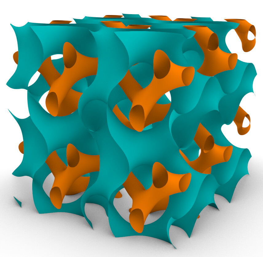

This seems to be 3D isosurfacing ! Nothing new
. Millipede was good at it but now there are also other tools.
… and counting
