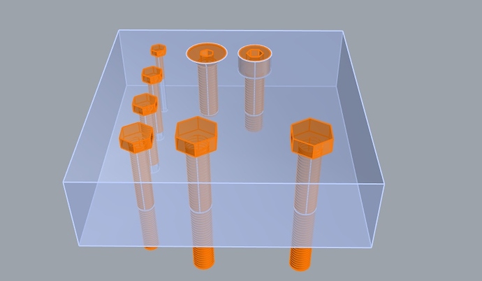

Working script to create metric bolts on the fly as block items (but some feedback needed)
addBolt.py (10.7 KB)
addBoltv0.2.py (11.5 KB) (sticky settings)
addBolt_v0.3.py (11.7 KB) (multiple bolts)
addBolt_v0.51.py (16.5 KB) (now works in all unit systems)
addBolt_v0.6.py (16.7 KB)
addBolt_v0.7.py (16.8 KB)
Attached is a working script that adds metric bolts (hex, flat head, socket allen, M3 - M8). I wrote this mainly as a coding exercise.
Would like to get some feedback from more experienced coders if the way i did this with classes is done properly or not. Suggestions for optimizing the structure of the code highly appreciated…
edit: would like to record last selected bolt options to change the defaults at next run…how?
edit: uploaded version 0.4 which that allows to add multiple bolts of the same type to (multiple) surfaces and added preview of the to be placed geometry
If you have additional suggestions for improvement of the functionality that would be nice too.

addBolt version 0.7
this script will add a bolt (named block) in Metric size to the rhino document
Bolt must be oriented on a surface and can be aligned with a center point
needed user input : metric size, length, bolt type, (center)point on (poly)surface
to do:
-rewrite Bolt creation in Rhino Common so that redraw can stay on for showing selected center point
changes in v0.2:
- added sticky values to size, length and type to make insertion of multiple bolts of the same type faster
changes in v0.3:
-add multiple bolts of same type to one or multiple surfaces
changes in v0.4:
-added preview during placement
-replaced most rhinoscriptsyntax with Rhino common calls to avoid adding objects to scene too early
changes in v0.5:
-now works in all unit systems
-fixed bug in socket_allen
changes in v0.6:
-refactored spiral creation and made it generic with extra bolt property 'lenght_with_thread'
 which should make it applicable to all kinds of bolts that might get added later
-split user options from main function
changes in v.0.7:
-all options in command line at once (code by Willem Derks)
script written by Gijs de Zwart
www.studiogijs.nl

a flip option would be interesting while selecting surface to orient on. there is one little bug (mac rhino 5 something) when i am supposed to select the surface to orient on and i zoom in with the mouse wheel it hooks up, i have to cancel it completely. regarding code i cant say much.
could be but then it would only make sense if I have a preview of the bolt while placing it…
yes would be nice

I was currently looking at a way to show a preview but this I still find hard, even though I managed to make it work with a few scripts before.

I’ve uploaded a new version which adds preview and option to add multiple bolts of the same type
I had to use a global variable in order to get the display thing working. Don’t know how I can otherwise send the variables I need over to the Dynamicdraw function.
