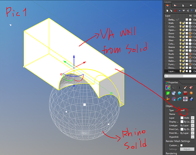

I have two Rhino breps and want to use the VA ‘live’ boolean tools on them. Arbitrary objects, that have nothing to do will holes in walls, like two spheres or whatever.
For that, I have to convert one of them into a vaWall, otherwise the vaAddSolids/vaSubstractSolids commands won’t recognize it as the first input object. The second object can then remain a normal brep.

Yes it does. It’s meant to make it possible to add or subtract any brep from any VA object, but with the ‘trick’ of converting any free brep to a vaWall first, you can boolean anything.
After doing so, you can turn on control points for the object and will see the boolean ‘members’ with dashed lines and a central handle to move it

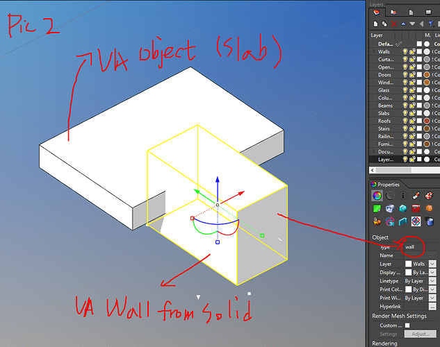

In my understanding, you’are talking about Pic 2, but nothing happened. VA boolean does not work, because both two objects are already VA object.

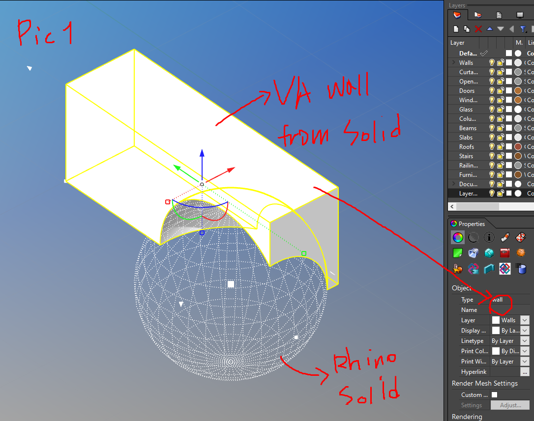

I could see dashed boundary and a central handle that you mean by from Pic 1, but these are rhino solid and VA Wall from solid. You said ‘live boolean’ works betwwen any brep and any VA object. Probably this is not the case that you mean.
