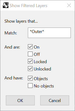

I frequently have hundreds of individual layers and sub-layers to navigate through. The default layer tab is often tricky to navigate with such high numbers of layers. A solution I have come to think might make life easier is to be able to change the colour of the background of the layer name, either manually or as per a set of rules (eg. one colour per level (parent/child) of said layer. Depending on the colours used, the colour of the text would also likely need to be able to change.

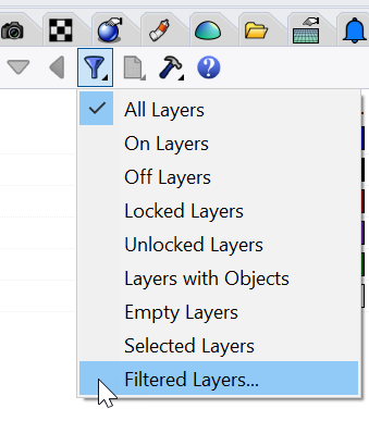

Hello - for now, you can try using the layer filtering:
