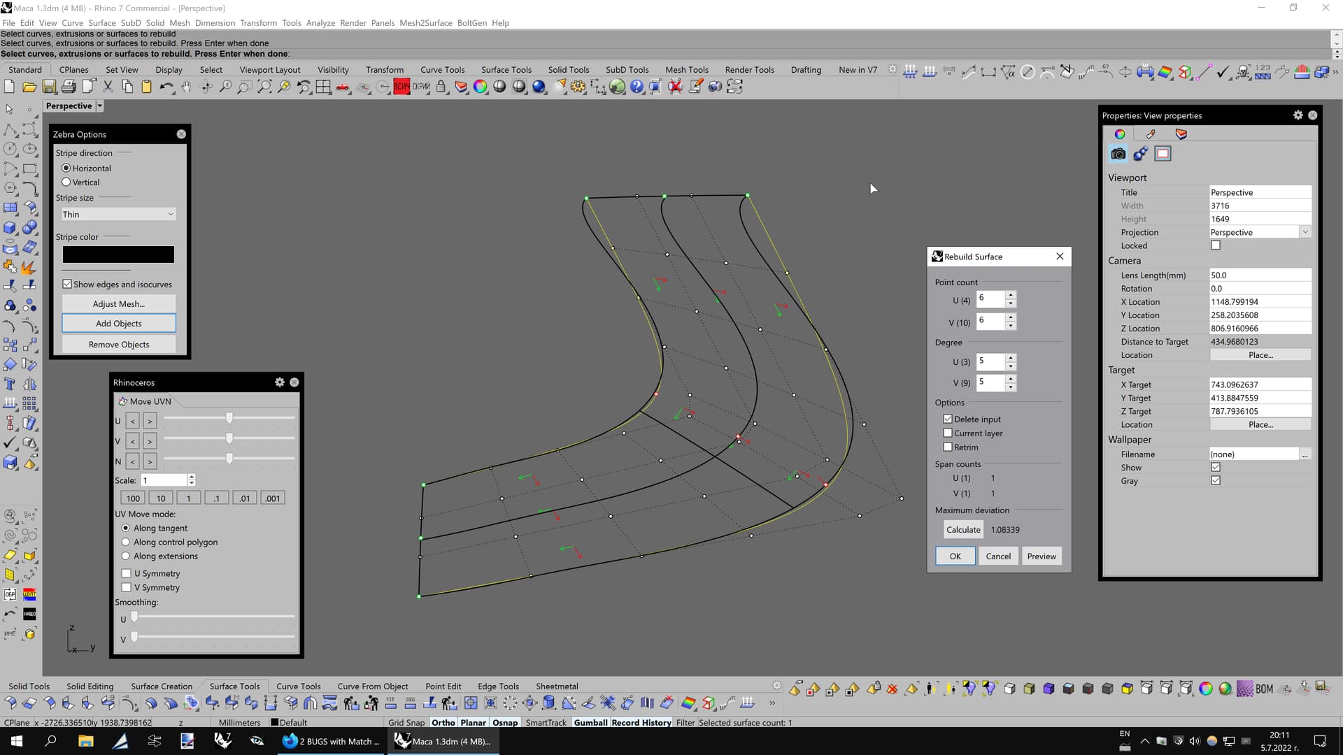

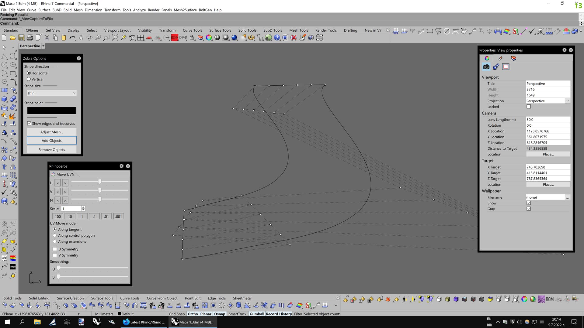

Quite often rebuilding a surface to degree 5 results into an extremely distorted output surface whose shape and control point arrangement has nothing to do with the input geometry. A new option called Preserve CP flow" that tries to keep the control points of the output surface in relatively the same arrangement would help a lot to avoid those inconsistent weird looking results that lead to frustration and time consuming manual fix.
This is true… Rebuild, in its current state, samples the input and then inerpolates the samples, so it can indeed wobble quite a bit at low point counts.
Hi Pascal, is not it more appropriate for the “Rebuild” command to take the input surface’s control point structure into consideration? That way, the resulting output surface will not look so distorted, especially if the goal is a Bezier surfaces with Degree 5 and 6 control points. The example I posted above is extremely distorted and basically unusable due to the chaotic zig-zag position of the 3rd row of control points at either end.

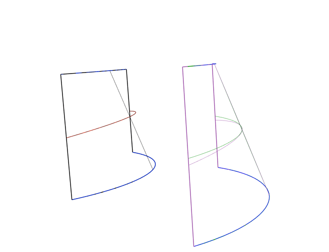

a simple example:
left:
lofting 2 arcs with different angles will result in different “speeds”:between edge and mid-isocurve (u-direction). resulting in the bended red isocurve.(v-direction)
right
rebuilding this surface (violett) will inherit this unequal setting.
(cvs don t have same distance).
while redoing a loft from the edges will have nice CV-distribution (green)
rebuild_srf_by_arc.3dm (65.4 KB)

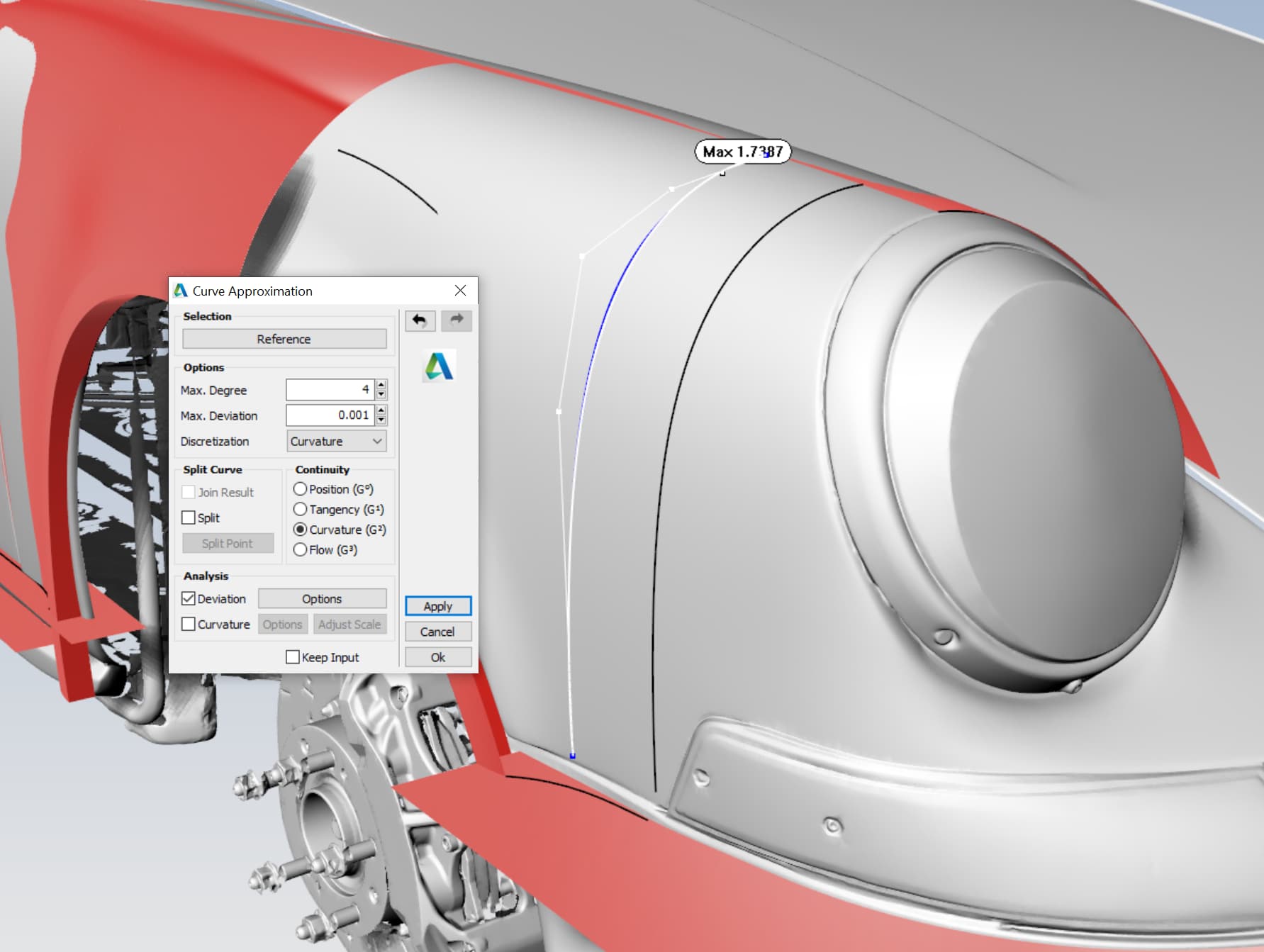

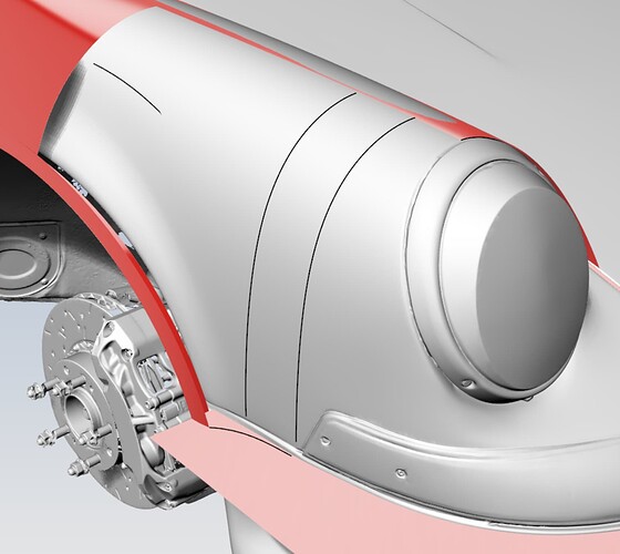

Slightly tangential but related - here’s a good example where it’s very nice to rebuild with a Curvature calculated point spacing/parameterization:
I’m rebuilding these two curves - in this case these are planar intersections of laser scanned data, so the intersections curves themselves are very dense, and evenly so. The shape of the curves is best done by a non uniform point distribution, so in this case, having a “Curvature” option in VSR yields a nice result:
If I had a version of this curve that had the right point distribution - more at the top, less at the bottom - but too many points, using the “Original” option would have yielded a likely similar result - it’s really good to have all three options - MOST of the time “arc length” is the right choice, the other two options really come in handy from time to time.
