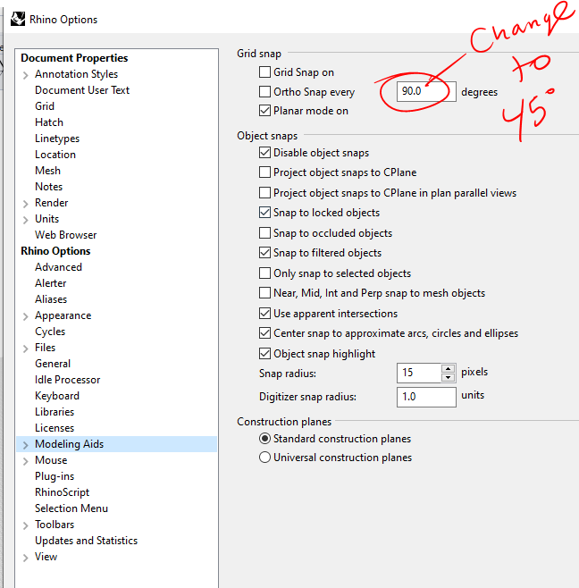

In Options, Drawing Aids, set Ortho snap on and to 45 deg (or whatever value you need).
Then toggle the Ortho Snap on and off as required. If you don’t like using the mouse to do that then, on default McNeel keyboard settings, F8 runs the relevant command. Don’t like F8? In Options, Keyboard, copy and paste the command from F8 to the key of your choice.

Why cant you set ortho to 45 degrees, hold shift and press tab to lock the direction?
Ctrl-D for diagonal, maybe.
setting ortho snap to 45 deg sees all lines 0 45 90, shift tab simply locks to one of those,
My wish to be drawing lines at any angle as normal then constrain one to 45 is then then something I would need to ‘ask for’ each time.
Ctrl D does the ‘ask for’ it stops the constraint.

Shift tab locks to ortho direction even while ortho snap turned off. Seems like @jasper has a good solution.
with ortho off I hit shift tab and it allows 90 or 0, but no 45.
in ortho snaps I have it set to 45.
Steve
It works fine at 45 deg here in R5 and R7. Are you pressing Shift and Tab simultaneously? You need to press Shift, establish the direction with the mouse and thereafter press Tab.

Now I dont know how its happened, but suddenly shift is constraining to 0 45 and 90 deg, just as I wished !
That will do me and I dont know how it decided to do that !
No doubt tomorrow it wont, but great whilst its happening.
ortho snaps are off.
Jeremy,
shift then tab, well the shift is enough as I then click where I want the 45 line to go. but with ortho snap off on properties>modelling aids I am not sure where its taking the 45 from.
