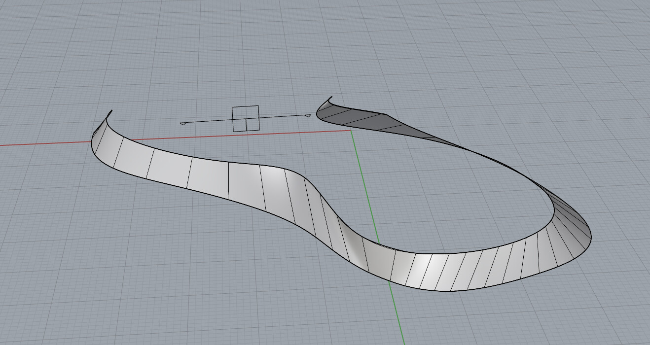

Hi I need to SubDLoft pairs of closed curves but would like the surface sections to remain completely straight. I’ve played with the options but nothing seems to address this. The resulting surface needs to be SubD.
Any quick fix for this? Thanks, Adam

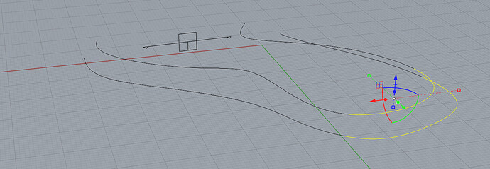

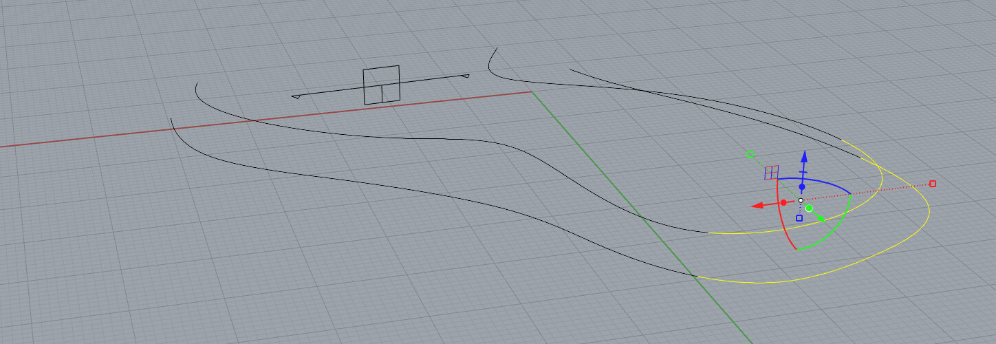

I’m still learning here, but looks like if you split those curves before you loft, you can have better control over the result.

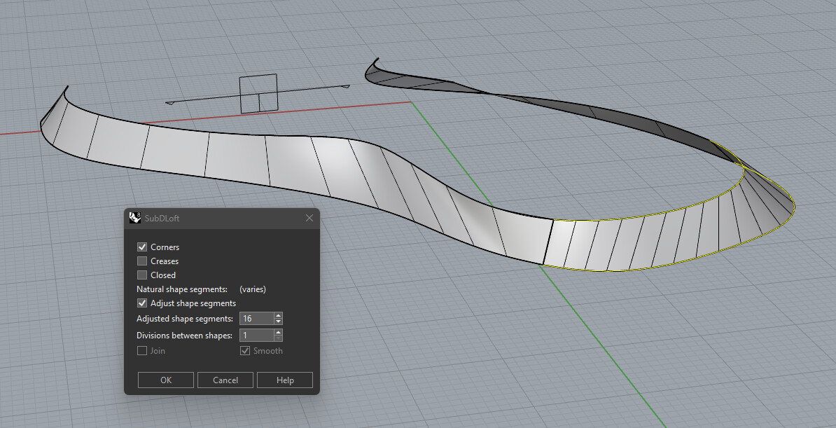

Here I split your two curves, then lofted both sections using SubDLoft with Corners, and increased the number of sections.
You can then join the two surfaces if needed.

Thanks for the workaround. Hopefully I can avoid splitting the curves but if there’s no other way I’ll do this! Cheers

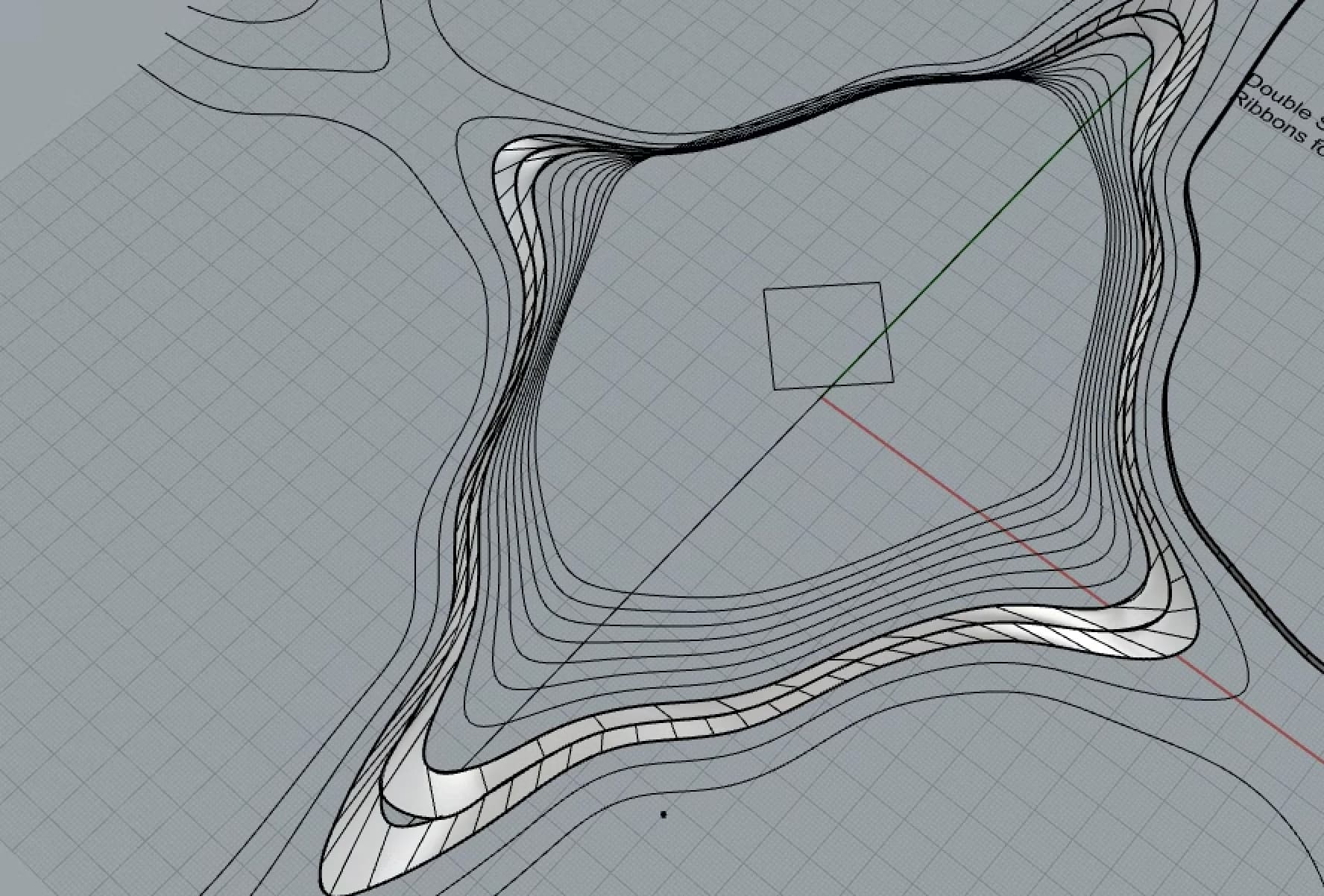

I’d do this with with BlendSrf > Rebuild > ToSubD…
If you did every other pair of curves this way, and kept your rebuild numbers the same, you could then use Bridge to get the in-between SubDs. This would be ideal if you plan to join the SubDs into one preserving the creases or not.
I hope that helps.
