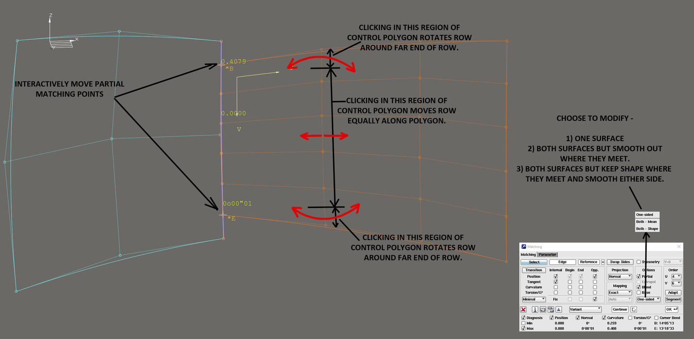

Surface matching - this one has many options so is a bit difficult to explain but I’ve done my best to pick out the important/useful items that I use a lot.
If anything is unclear I can try to explain further…
The desire would be to have at least these two tools in Rhino that work in a similar way to those of Icem Surf or Alias: Match srf and Blend surface. At least these two.
I also would add regarding to the icem matching tool (great explanation Rob), that:(in VSR also was possible If I am not mistaken):
Moreover, there is the possibility to add spans (or segmentation in icem) to reach the required matching condition.
