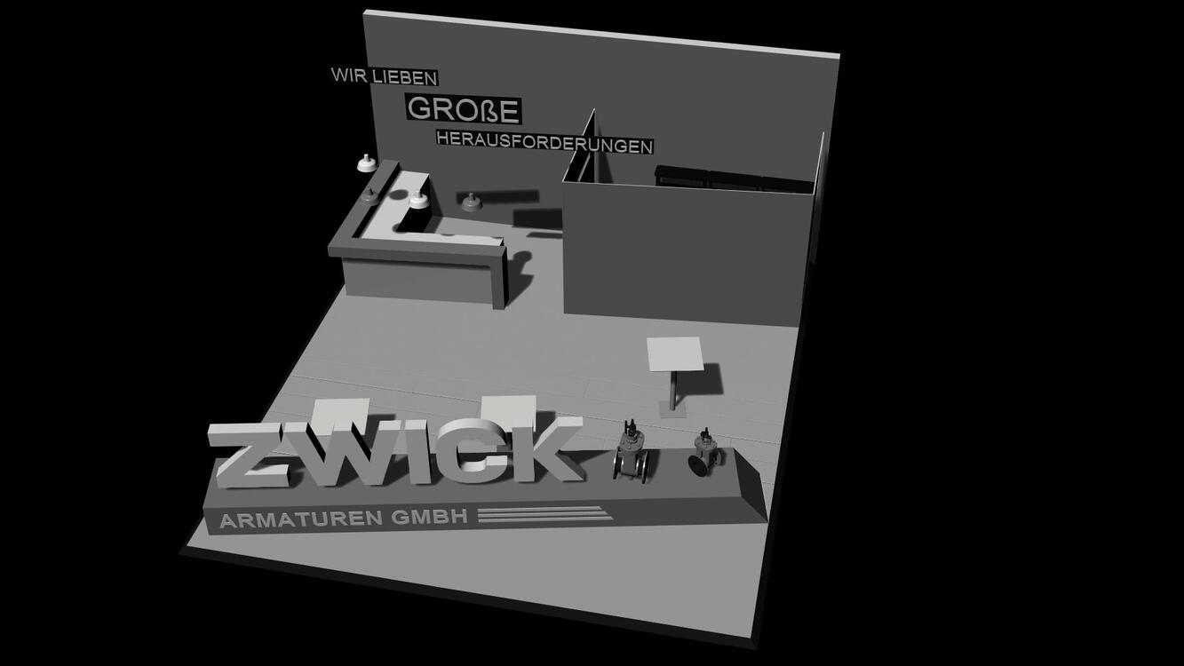

Hey Guys I´m using Rhino 5.0 and recently updated Vray to 3.6. The Render seems to work fine but somehow I cant see the materials in Rhino viewport, they only appear black. I already tried different materials and changed display mode settings. Any Ideas?
Which display mode viewports you are selected ?
Its my shaded mode. But its the same in Rendered mode. just black.
Try to change display mode to Realistic mode .
There is no realistic mode in Rhino. But I dont think its about display mode, I checked the settings and it should show the render material its the same as in teh rendered mode.
SOLVED!
Okay I know what the problem was. The Texture Image for the material was simply to big. The Size of the Image 6700 x 2700 ( 3,5 MB) couldnt be shown in the Vieport. I made it smaller and it works. Thank you
