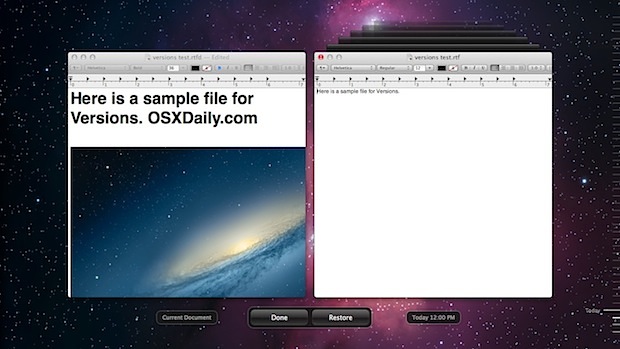

I check the dropdowns in Rhino. Under file is an interesting point “Revert to” -> browse all Versions. while clicking this you get in an time machine looking menu with all Version.
My Question now is: How can I delete old sometimes very old versions of the file?!
#3
“Navigate to the File > Revert To > Browse All Versions… When the Version explorer appears, move the mouse pointer to upper border of your screen and the Rhinoceros menu bar will appear. Under File > Revert To you can delete a single old version or - if you hold down the option/alt key - you can delete all previous versions”
