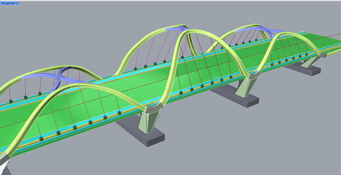

Hi @sebastian.lindholm and @Oskar_Scherdin, I’m currently working on several warped/twisted hollow beams
The way I’m doing that: Put the solid beam first and modify it into twisted one. Then, adding a dummy beam as a hollow section, and also modifying it to be twisted as well. Then put it 1st beam does “part-cut” with 2nd beam but the result not correctly. You guys has any alternatively way to solve this?
wraped beam.gh (18.4 KB)
Hi @Nguyen_Anh_Hao ,
I would personally avoid cutting out a beam like that, I would instead use a hollow crossection then it will automatically follow the beam orientation and also drastically speed up your model in the case where you have many of these.
Cheers,
Oskar
Yes, many of twisted beam in this arch. These beam seem not appropriate for Tekla when using item component convert from B-rep because huge amount of control points.
I guess dividing into small chunk beams will be better idea!
Hi, your definition works well when I try it, so not sure why you get the results you’re getting.
But yeah agree with Oscar’s suggestion about using/creating a hollow cross section instead.
