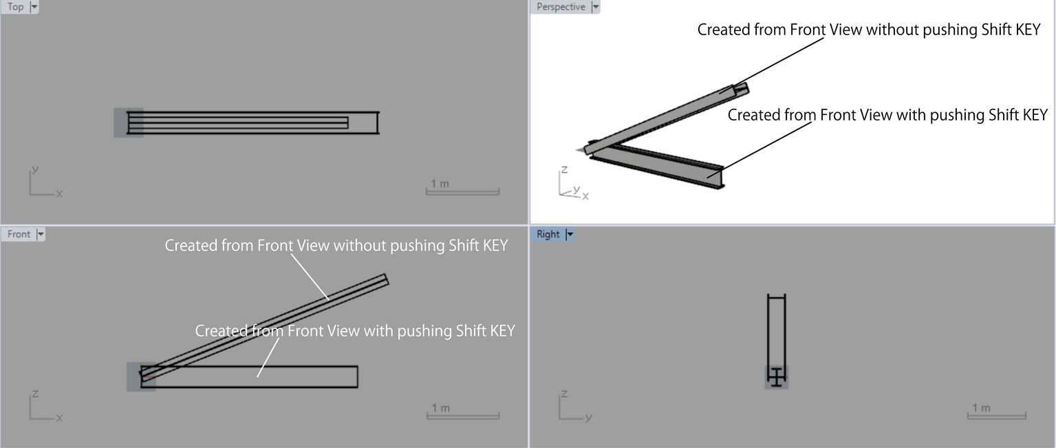

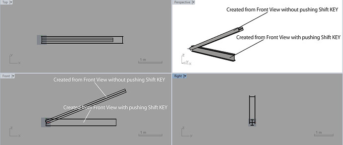

Thank you for the reply.
Here’s screenshot.
I mean 「va_Beam」 produces differrent beam angle.
When I create H-Beam from Front view, Its angle depwnds on pushing Shift key.
Pushing shift key, flange faces me. Without pushing shift key, web faces me.
What happen when I generate GH definition Beam?
Sorry for my poor english,
Best
Shimpei

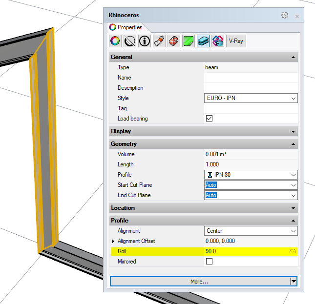

@11194 Ok, I could reproduce this error but drawing beams vertically instead, also in Front viewport. We need to review this error. Take into account that you can rotate the beam from the properties panel, (Roll parameter), in case it was not created propery.
In case of beams created from GH styles, their rotation will depend on the definition parameters.
