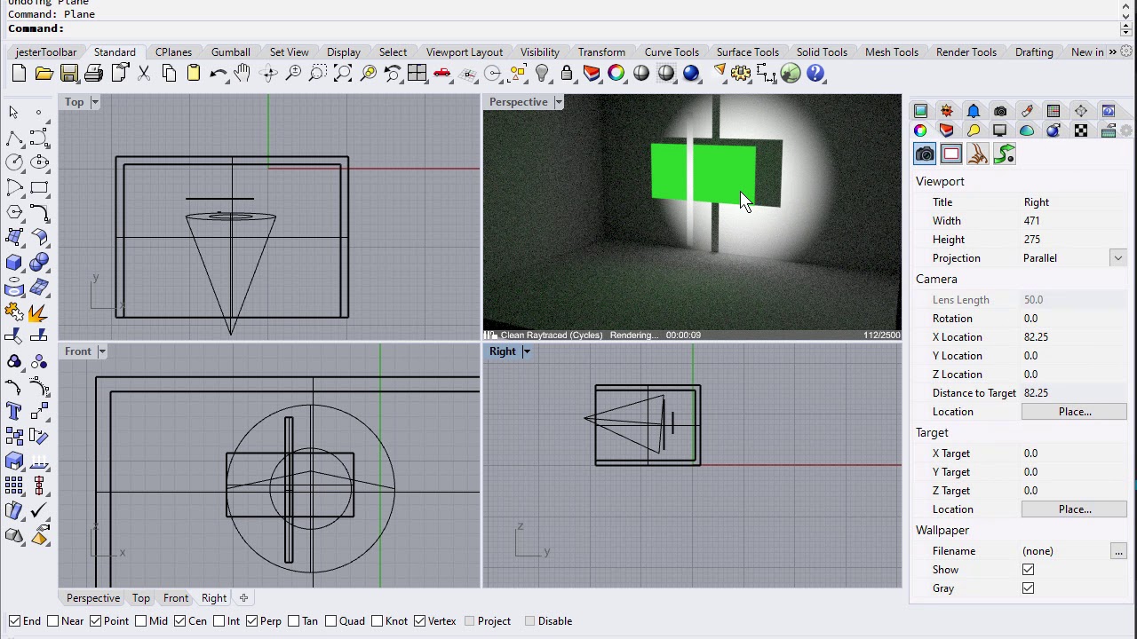

Can you please attach a material that shows this problem?
If you mean that changing settings in Tools > Options > Cycles doesn’t automatically restart viewports that have Raytraced active then that is on purpose. Toggling of the viewport is needed to have changed settings in effect.
If you meant something else, then please elaborate.
An object that has a material with self-illumination enabled still will throw itself a shadow if in a light path.
This is how it works

There are times, when users will want objects to self-illuminate and not cast shadows. It’s really hard to fake any kind of lit surface such as a lamp, without this ability. It would be nice to at least be able to put a pointlight in an object set not to cast shadows.
Otherwise, how would you make a light globe?
You could put a half dozen pointlights around it, but after a while the renderer and the videoport isn’t going to like that.

I would make a light globe with a mesh shaped in the form you need it and a Cycles Emissive material. With the command TestShowPrivateContent you get access to it. You get essentially a ‘light’ shader with three fall-off types (0 - constant, what Rhino uses, 1 - Linear fallof, 2 - quadratic falloff). You’ll have to play a bit with the energy/strength setting, it depends on the size of your mesh. You can also uncheck the Hide box, so that your mesh is visible together with the lighting effect.
Correct, don’t do that. For Raytraced you’d add one point light with intensity set to 0 (this is a hack), then add as many meshes with emissive material on.

Wait! There’s not lights around that?
I reread your post. Can Cycles objects become light sources?!
Yes, with Raytraced you can make objects into lights. Those lights can either be invisible (the geometry), although their light shines into the scene. Or those can be visible (so both light and the object). That is what you see in the screenshot I posted. The oval ring is a Circle followed by a Pipe, then squashed a bit. The bulb-object is a Curve that I Revolved. Both have a Cycles Emissive material, making the into lights.
Since Rhino doesn’t know those are lights one needs to (for now) add a light source that has intensity set to 0 (but is otherwise enabled). Without that Rhino throws in a camera-based scene light - a bit ugly :wink:
