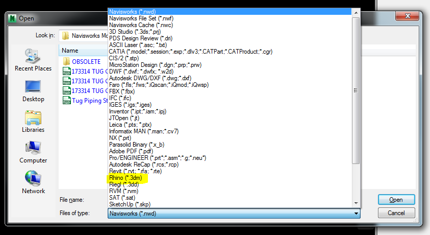

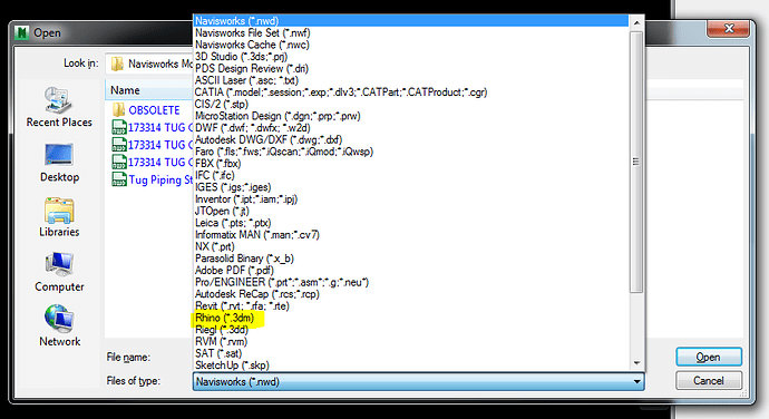

Navisworks can directly open .3dm files (V5).

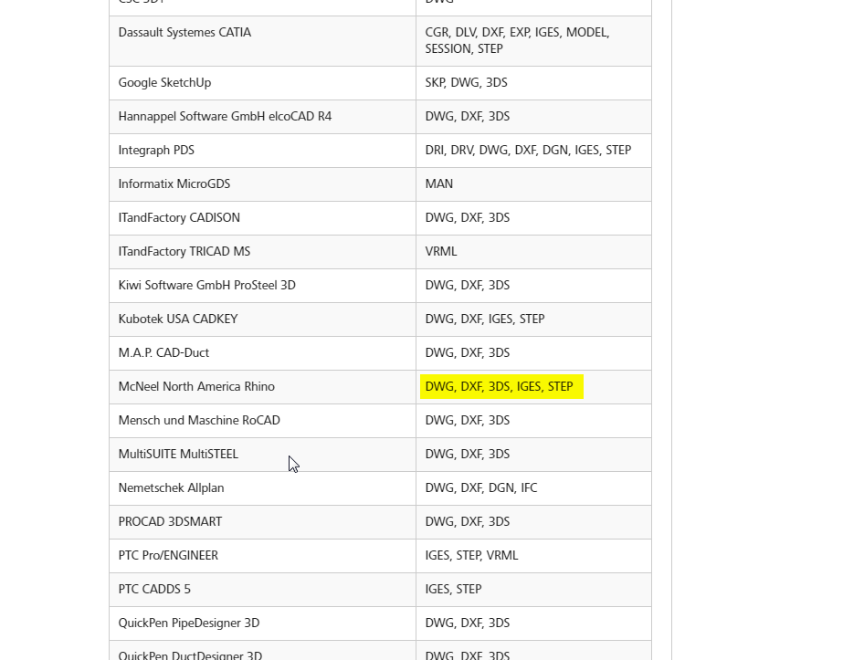

Humm What version are you using of Navisworks, because i don’t see an open setting for .3dm files and navisworks website doesn’t show it can. It actually states to export to a dwg file.
Navisworks Simulate 2016.
Edit: I think 2016 was the first version to offer direct 3dm support so maybe their website is out of date…
