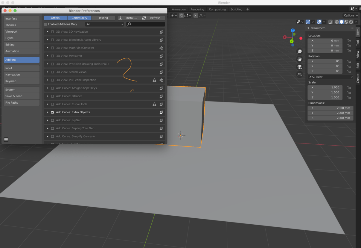

From the latest link (Release import_3dm v0.0.7 · jesterKing/import_3dm · GitHub) I downloaded the zip “import_3dm-v0.0.7.macos.zip”.
In Blender 2.90a for Mac I go to Edit → Preferences → Add-ons → Install
  1. I locate and select the zip folder, and press “Install Add-on” (screenshot)
  1. This takes me into the folder, strangely, so I press “Install Add-on” again (screenshot)
  1. I get taken back to the Preferences window as if nothing happened… (screenshot)
Is there something important I am missing? Tried the exact same in version 2.82 with same results.
Thank you for your help!
I made a small mistake while creating the zip file. I have re-uploaded it to the github releases page. Please redownload and install the zip (don’t uncompress or open the zip with Finder).
